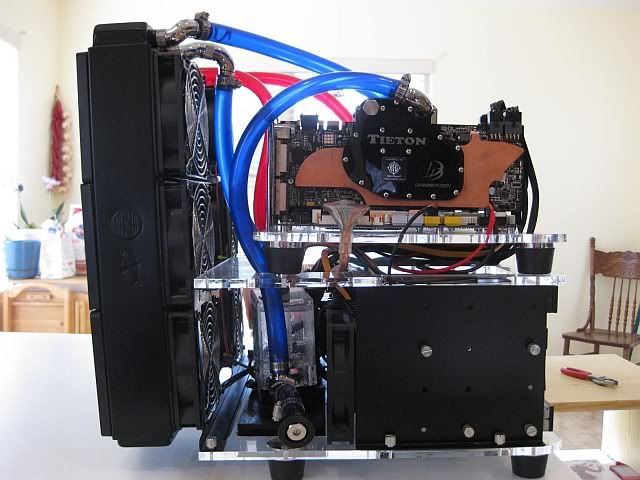

Sure. Dunno what watercooling you been looking at. This is real watercooling.
January 31, 2011 9:30:36 PM
Aaaaaaand Conumdrum'd, all further discussion against watercooling is now invalid.
a c 328 K Overclocking
January 31, 2011 9:31:22 PM
Hey, Conumdrum, what test bench is that? I've been looking for one, not too many look like they support dual 3x120 rads...but apparently yours does.
I was looking at either modding one, or building my own...whatcha got there...a Banchetto 101?
