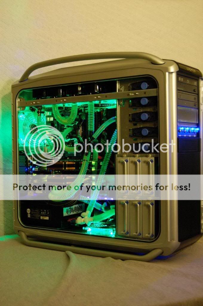

just copy the warpedsystems X4 i7 4.0SC - this runs 3.8-4.1ghz at 75-85c depending on the cpu binning
http://i63.photobucket.com/albums/h138/4rothrocks/DSC_0118-3.jpg
Warpedsystems does not sell systems to anyone on THG so do not pm me or contact make a post plz!
------------------------------ http://i63.photobucket.com/albums/h138/4rothrocks/WarpedSystemsAnimation-1.jpg

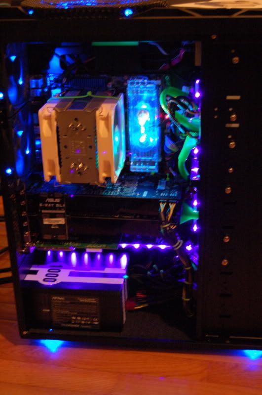

ps: thermalright is really heavy for shipping - and even handing off the mobo. the true is not better then what is shown in the photo above!
http://i63.photobucket.com/albums/h138/4rothrocks/DSC_0073-1.jpg

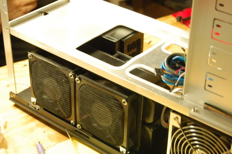

we use 70-77cfm 120mm fans - dual -seal around the fan with foam. compress the fans buy looping zip times from hole to hole see below:
http://s63.photobucket.com/albums/ [...] C_0158.jpg

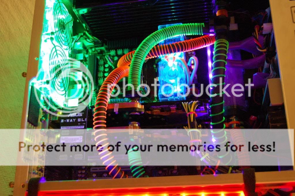

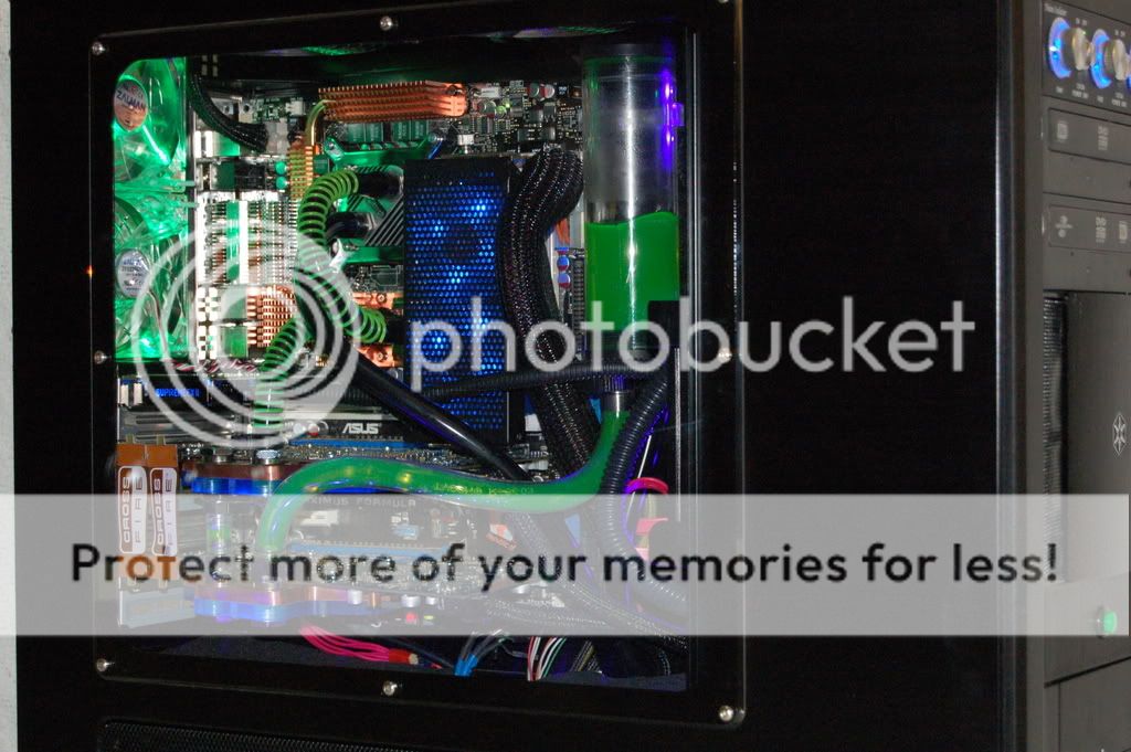

here just throw in dual rads or dual pumps or both!
http://i329.photobucket.com/albums/l373/warpedsystems/WSZ-WCcm-T61-1.jpg
http://i329.photobucket.com/albums/l373/warpedsystems/WSZ-WC44-1BBBB.jpg
there posting photos makes me feel better!!!!!
