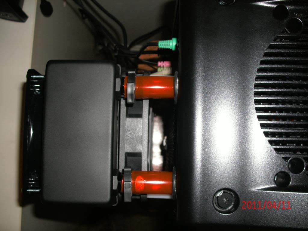

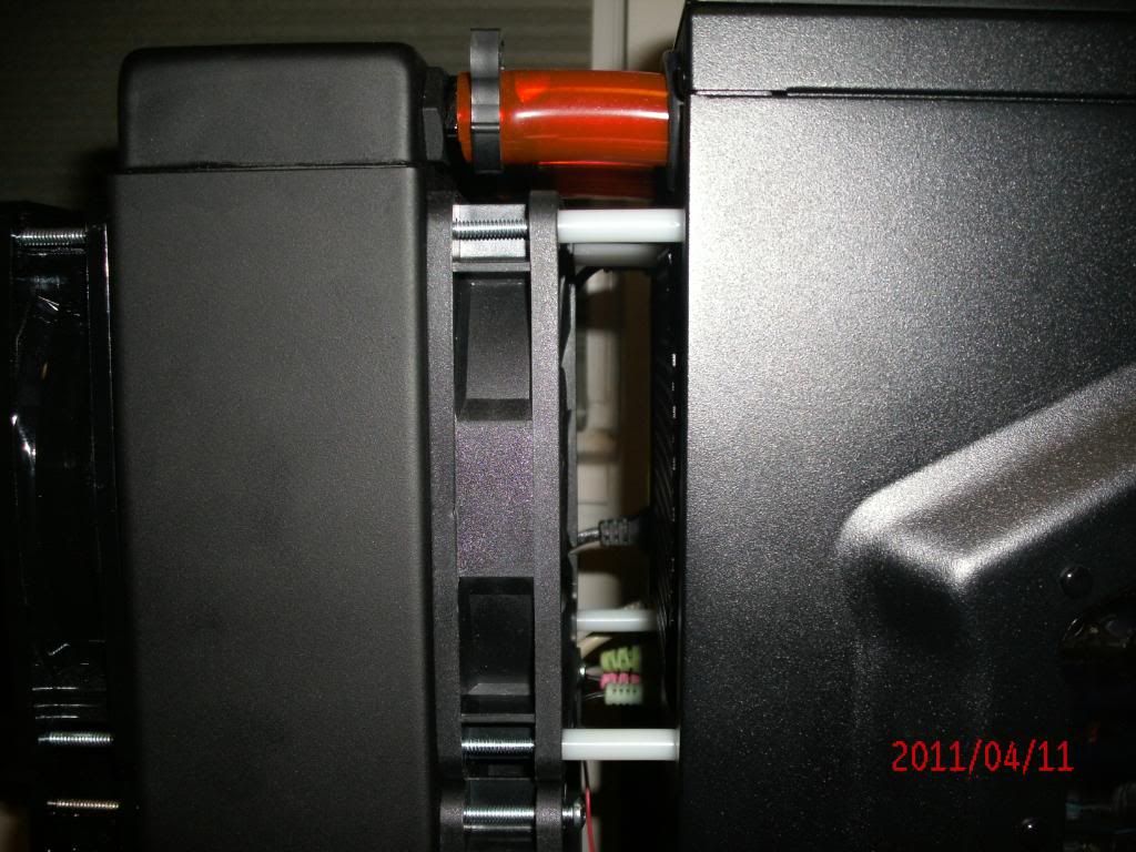

I also realized i will need to put some big holes in the back of my case to get the tubing out to the external rad... any suggestions on what i should do to protect the tubes from the case holes?
rubix_1011
Contributing Writer
Killcoil is fine, if you want to use PTnuke, you'll only need 1-2 drops total.
You might be able to find some grommets for any holes you drill; this will prevent tubing from rubbing in the metal. Hardware stores or an electrical supply store should have them for pretty cheap.

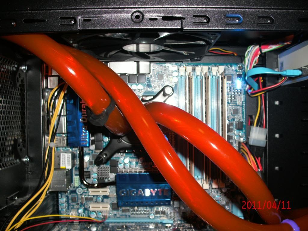

I ordered all of the parts I need (I think) and I will be looking to work on it next week in my spare time. so wish me luck! haha but i also have a few additional questions...
Will i need to keep any fans to run air through my case aside from a 120mm in the front pulling air in and a 140mm on top pulling air out? If so, why?
What benefit comes from having a larger res? Or for that matter would it be worth it to have 2?
I also watched some videos on filling the res, however i am still confused about when to stop... do you want to leave some air? or fill it entirely? If you do want to leave air, how much?
Thanks in advance for any answers.
