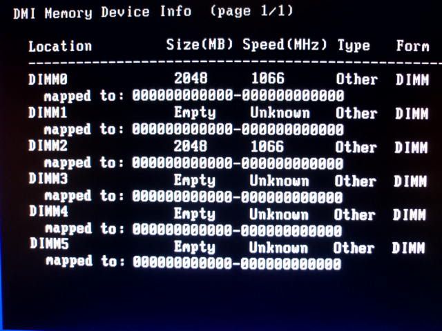

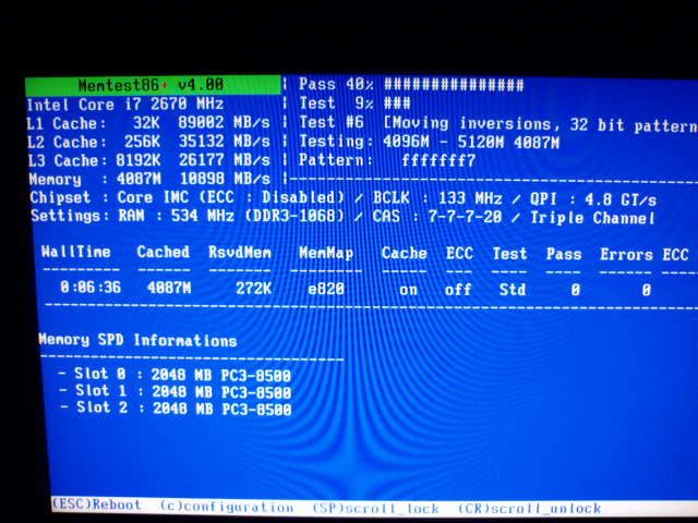

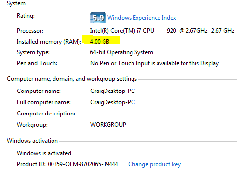

My problem is that my MB only sees the first two DIMMS. So my bios shows 4 gigs of total memory instead of 6. Therefore, windows 7x64 also only sees 4 gigs. HOWEVER, memtest86+ shows all three DIMMS at the bottom of the screen (picture below) but shows 4 gigs of total memory. The crazy thing is, if you look closely at the test being run, I took a picture of it when it was testing 4096-5120mb of 4087 mb of ram! How is this possible? This made me curious so I pulled up the view DIMM settings option within memtest86+. The picture below shows that DIMM0 and DIMM2 have memory installed but nothing in DIMM4 where the third stick of ram is. I switched up the sticks of ram and this doesn’t change. All three sticks of ram passed memtest.

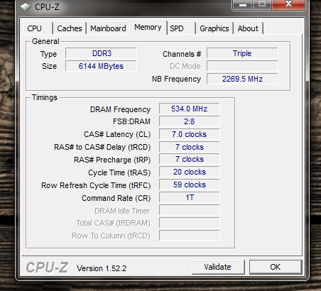

Moving on, in CPU-Z the ram shows as 6 gigs in Tri-channel mode. How is this possible? Has anyone run into this problem?
