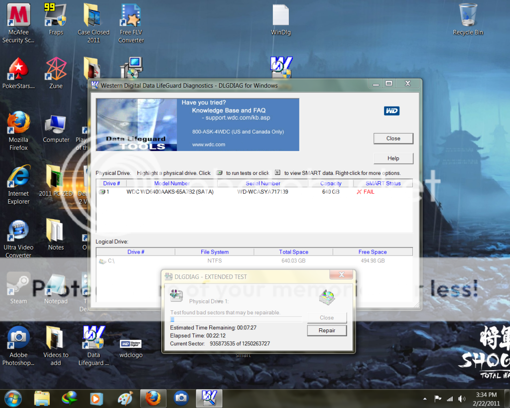

It says that it might take a few hours, now when i hit repair it says that if the sectors are repaired they'll take data with it like data will be deleted. I've backed everything up besides the OS (don't have windows 7 on disk) now is this something i should be concerned about? Will it delete dll files or exe files that stop me from starting up windows 7 and then resulting me to have to reinstall windows 7?
Yes, it's possible that fixing the drive can mess with the OS, but do you really want to use a drive with bad sectors? Better to fix it, right? This is why it warns you to back up first.
Most of these programs try to retrieve the data on a bad/faulty sector and move them to a known good sector if it can, otherwise the data is lost.

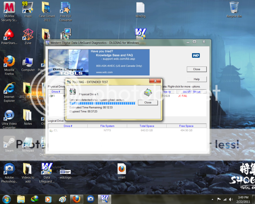

it seemed to have frozen, so i just hit repair and now its says error was detected while repairing bad sectors, this sounds like it might be unrepairable.
So...is it best to keep doing more test? Can this be fixed or am i just doing it wrong?

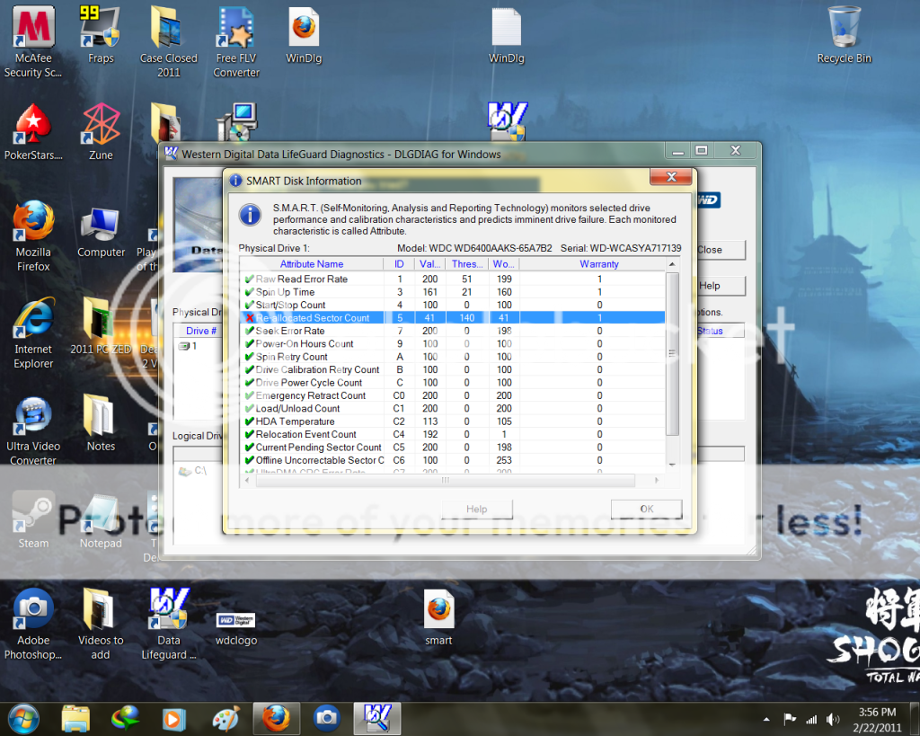

i'm going to try another program, this is what is says for the sectors....
Dragon Age 2, Shogun Total War 2 and Crysis 2 beta all coming in about a week and this happens...great timing WD.
The "current pending sector count" doesn't look to good either. If this is still within your vendor's warranty period, i'd get it RMA'd. If your vendor can't help, go to WD's site. They have a warranty checker. You just plug in the serial#. If it's still under WD's original warranty, you have more than enough evidence for an RMA.

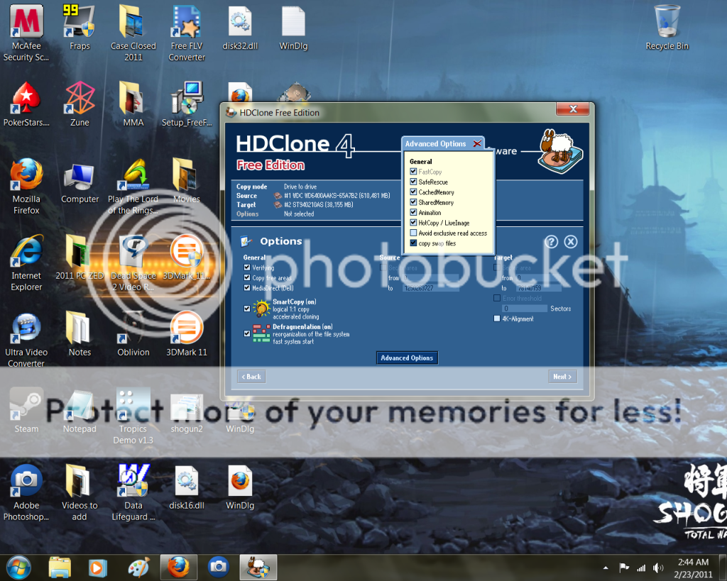

I couldn't find any of the documentation, it just kinda started up..and that was about it. I connected the second drive to my computer. Both drives are now in. My CD-DVD drive is not attached to it at the moment. Only the 640 (bad drive) and my 40gb laptop drive are connected. Now i used the 640 as the source and the 40gb as the target.
Note- i haven't formated my 40gb drive (will this be an issue) my PC can't see this drive, until i was in the HDClone program, the program found it. (Will that be an issue)?
these are the highlighted areas on the HD clone program. Is this okay?
Should check everything? Should i even use a HD first to copy or a blank DVD? Does it matter? I'm in need of help.

You cant clone a 640GB drive to a 40GB drive You need a drive the same size or larger.
When you downloaded Hdclone it came with a users manual in pdf form.
