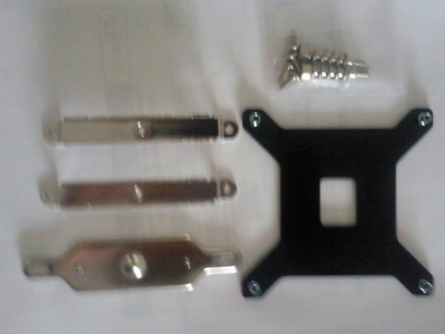

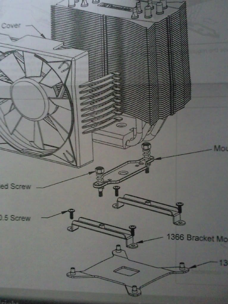

I've also been looking at getting this cooler for a long time and with an upcoming i7 build I finally jumped and got one. I just got it today and this thing is a beast. There is one thing however, they have changed the mounting bracket. I can't comment on it yet because I still have parts coming in for the build but from what the instructions show me the mounting is now a backplate two side bars that screw into the backplate (no springs) and then a crossbar that attaches with 2 spring loaded screws. I took a pic of the install instructions and the parts here:
http://i42.photobucket.com/albums/e301/NaomiHikaru/Thermalright%20cooler/Photo0040.jpg
http://i42.photobucket.com/albums/e301/NaomiHikaru/Thermalright%20cooler/Photo0045.jpg
The second pic is a bit blurry since they are from my cell and no tripod but I hope they will do. It may turn out to be a better solution to all the problems people may have with the turning. Also I looked around at the reviews and this seems to not be out there just yet, so I thought I would share with you guys. :D
Oh yeah like the first link of the hardware canucks review the box is like orgami awesomeness. Its all packed in there nice and tight. If you want pics of the box and how to open it I'll be more then happy to do so
