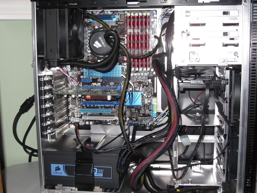

Matt,
Hola fellow p6x58d user!
I had the same concern but it seems to be running OK at ~1600 with all 12GB and the 920 OC'd to 3.8.
Right now I have all 12 GB running at ~1600 7-9-9-24 which is abount what I was hoping for. I mean, I was expecting it to be a little slower (timing or clock speed) with 12GB than 6 GB. 1.600v on the dramm
prime95 stable at 64 degrees C. Idle at 32C.
It did default to something much less but there is tons of info out there about how to OC these things.
Cables are kinda messy. The board looks good and seems well made. Very solid. I've built several machines over the years and asus has always been good to me. Case is a Lian Le with two 135mm exhaust fans on the top. I'm happy with rig. I'm not really into getting the maximum OC. I'm looking more to get something stable that I can leave it at all the time.
