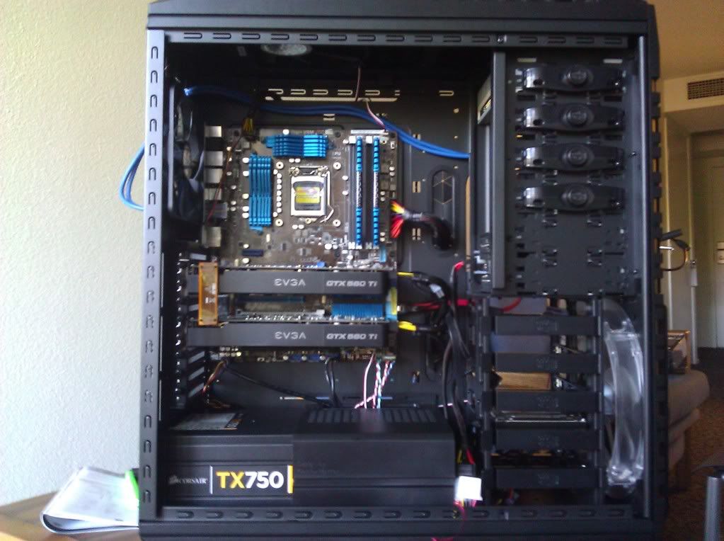

Alright, I know my cards rarely peak up to 80C but they do when I play games for hours.
I have the EVGA GTX560Ti Superclocked DS in SLI and I want to know.. are my temperatures too high? or does my cooling suck? And I did notice I have more Exhaust than Intake in terms of CFM, is that bad? Should I have more intake than exhaust?
My first card is idle at 34C but hits 80C max
My second card is idle at 32C but hits 77C max
I am not sure why but they is a temperature difference between the 2 cards even though airflow should be the same.
I have a total of 8 fans in my case excluding the GPU fans....
I was just wondering, such a high temperature is due to it being Overclocked? card just runs hot...? or my cooling just sucks?
CPU Fan:
2x 120mm 2000RPM, 69.69CFM in push/pull towards back exhaust
GPU Fan:
2x 80mm on each card
Intake Fans:
1x 230mm 110CFM @ 700RPM intake infront
1x 200mm 110CFM @ 700RPM side intake
1x 120mm 69.69CFM @ 2000 RPM intake in optical bay
Exhaust Fans:
2x 200mm 110 CFM exhaust up top
1x 140mm 110 CFM exhaust back
^ There's plenty of room right for airflow? or should re-route the PCI-E x6 pins from the bottom instead of from the back grommets?

Don't worry.
1) Graphics cards do run hot under load, but they are built to do so. If they overheat, they will downclock to prevent damage. I would only worry if the temps get over 100c.
2) In a sli configuration, the top card will run hotter because it is getting hotter air for cooling.
With the pxi-e slot separation you have, that effect is less.
3) Overclocking anything will cause it to run hotter. It is a problem only when you reach the maximum heat threshold.

Lol that's a lot of heat though, unless I'm liquid cooling, I don't want to make my card run hotter than 85C
100% fans? damn that's loud.. did you use a program to overclock that? In example: EVGA precision or MSI afterburner?
What is a good temperature on max load though? I don't want to shorten the lifespan of these cards by going over a certain temperature, that's my only gripe on overclocking.

I used msi afterburner. and yes it is loud, but i wear headphones anyway.
Your temps are fine.
If you really think you need to OC to get more performance, then you should consider a more powerful card.
In know, I know, we all want something for nothing. But.. do you really need it?
Graphics card vendors bin their chips, and put the better chips in their pre-overclocked units so they can sell them for a premium price.
Just register your card with EVGA within 30 days, and you have a lifetime warranty.
That also sets you up for a 90 day trade up program if you want more performance.
