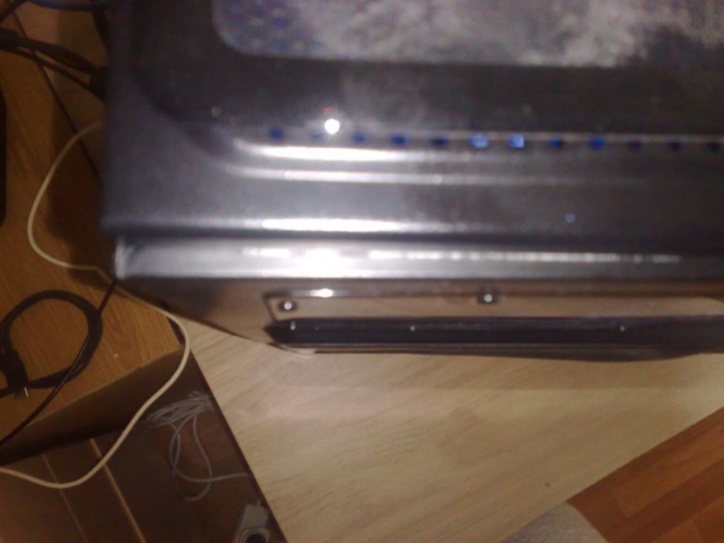

Hello all.
This is my first WC build and I would like comments.
Praise my work or tear me and my work apart. All and any comments appreciated.
I have a problem with my H70 which when I convince shop I bought it from to take it back will get removed
Here is problem description in picture
PS Cable management is not best......

Looks like a DDC+top/res. What 320 rad are you running? What GPU blocks? Nice build...might consider tossing that H70 and adding a CPU block and another 220 rad to round out the entire build. :) (just a suggestion...as long as you are fine with the H70, stick with it...let us know what you find out on it. Your pic doesn't seem to show the issue you mentioned, though.)

When I try to close side panel of the case I cannot screw both screws in because H70 is to wide. At the moment only bottom screw is in. I thought you can see that there is a 10 mm gap on the top of the case.

Is the rad on the H70 square? Is it possible to rotate it so that it fits? I have a similar issue with my SR1 120mm in my rig; the side panel barely shuts all the way.

Rad is 120mm square with part that water hose is attached on cca additional 200 mm.
I tried to rotate it but it cannot be done. My case has option for PSU mounting on the top as well with metal "legs" that are in the way.
