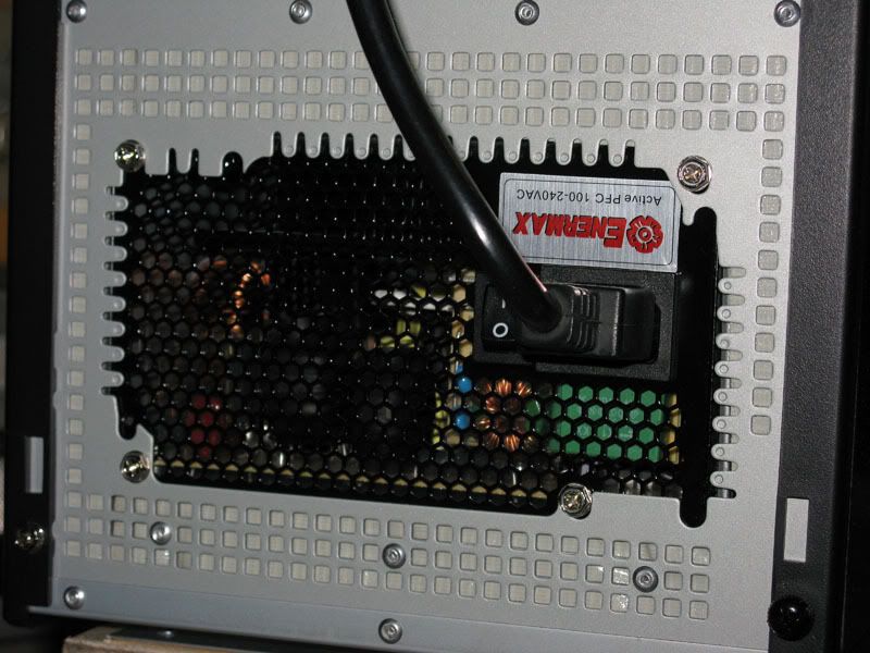

As suggested at the Silent PC Review site, I applied duct tape over the rear vents around the power supply opening and removed the fan from the lower chamber so that the PSU's fan draws air through the lower chamber to cool the hard drives. This works very well and makes it easier to route cables from the PSU to the drive bays.

u mentioned duct tape which im not quiet familiar with your setup.have any pictures to illustrate this?
The idea is to prevent the PSU fan from drawing air in through these vents at the rear of the case instead of through the front opening. I applied the tape to the inside, which is a little more difficult to do but a little less ugly to look at:
http://i141.photobucket.com/albums/r64/SMN-8711/Computers/IMG_7466.jpg
http://i141.photobucket.com/albums/r64/SMN-8711/Computers/IMG_7467.jpg
