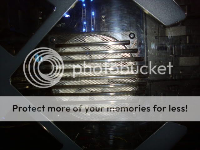

Thanks for the detailed response. I will try that sometime this week. Any chance you could send a photo of your rig?
Actually, I'm currently working out minor issues in my rig, as I have just got it fully operational. Having issues with heat mainly, due to improper airflow. The wiring is also all over the place, and temorary lighting in place.
As you can see, there are things that need upgraded/ replaced. One of the 2 HDD was old and recently quit. Also, trying to find a proper place to route the hoses for this thing is being a real PITA. Another thing, my window needs to be waxed and/or replaced with clear glass instead of that tinted stuff.

95EscortDriver said:
Actually, I'm currently working out minor issues in my rig, as I have just got it fully operational. Having issues with heat mainly, due to improper airflow. The wiring is also all over the place, and temorary lighting in place. As you can see, there are things that need upgraded/ replaced. One of the 2 HDD was old and recently quit. Also, trying to find a proper place to route the hoses for this thing is being a real PITA. Another thing, my window needs to be waxed and/or replaced with clear glass instead of that tinted stuff.
The Kuhler looks mighty fine in your black case.
Thanks for the photos. It looks similar to my setup with the radiator in the rear exhaust. I noticed you also zip-tied the pump hoses, might do the same.
Will let you know how I go with getting rid of the air bubbles. Looks like your rig is coming along well.
