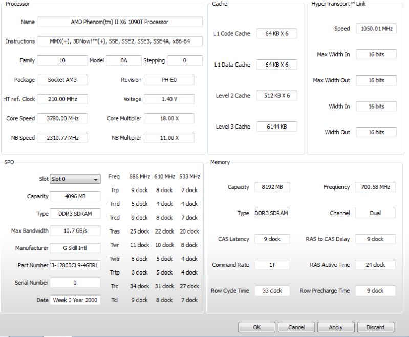

I've been overclocking and stabilizing all weekend. I have a 1090T and every time I run AMD Overdrive's stability test for an hour it finds no problems.
I can run Prime 95 blend & large fft's tests for a few minutes until worker #5 stops working due to: FATAL ERROR: Rounding was 0.5 expected 0.4 or less.
I've read people posting similar issues a while back on here but none of them had huge success fixing it.
What I am wondering is if I can continue running the torture test with that one worker down or should I stop and fix it first? I upped my RAM voltage from MFG Suggested voltage of 1.5 to 1.6.
I am over clocked from 3.2 to 3.8 can upload screenshots from Overdrive in a little bit.
Just ran blend test for about 2 hours now and it crashed my computer. Will report back with actual BSOD error next time it happens.
Biostar A880G+
Phenom II X6 1090T
2x4gb g.Skill RAM 9-9-9-24 @ 1333
650w Coolermaster PSU
Radeon HD 6850
