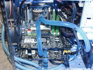

Copy/paste from my member config:
Q6600 @3.4ghz 1.2250 VID
BFG 1200w
eVGA 790i FTW
4gb Patriot DDR3
SLI GTX260 Core216
2x Raptor 74/1TB WD Black
Gigabyte Aurora Case
D-Tek v.2 CPU, 2x MCR320, 2x Swiftech MCW-60 VGA, MCP655
28" Hanns-G
MS Sidewinder & G15

That's sick!

August 25, 2011 10:17:04 PM
It's older hardware and older WC gear, but still runs great. SLI GTX 260's and a Q6600 @3.4ghz...runs great on 4gb RAM.
