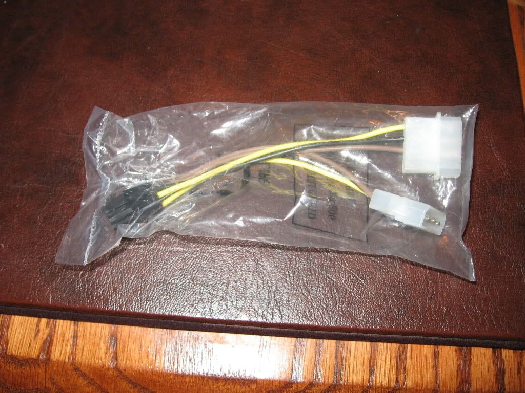

http://i802.photobucket.com/albums/yy308/zachblaesi/IMG_0504.jpg
My video card has two slots. My power supply only has one cable that fits this slot. Am I required to fill both slots on my video card? If so, is that what this is for?
http://i802.photobucket.com/albums/yy308/zachblaesi/IMG_0506.jpg
If so, does that plug into my power supply (twice) and then into my video card? If so, that's exactly what I did, and I'm fine so far.

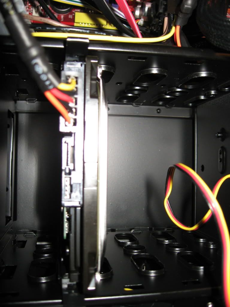

http://i802.photobucket.com/albums/yy308/zachblaesi/IMG_0503.jpg
This is my hard drive. That's a molex connector (I'm pretty sure) from my power supply plugged into it. All else I need is a SATA cable to connect it to the motherboard, correct? If so, I'll be good to go later today. (Hopefully radioshack or office depot sell SATA cables!)

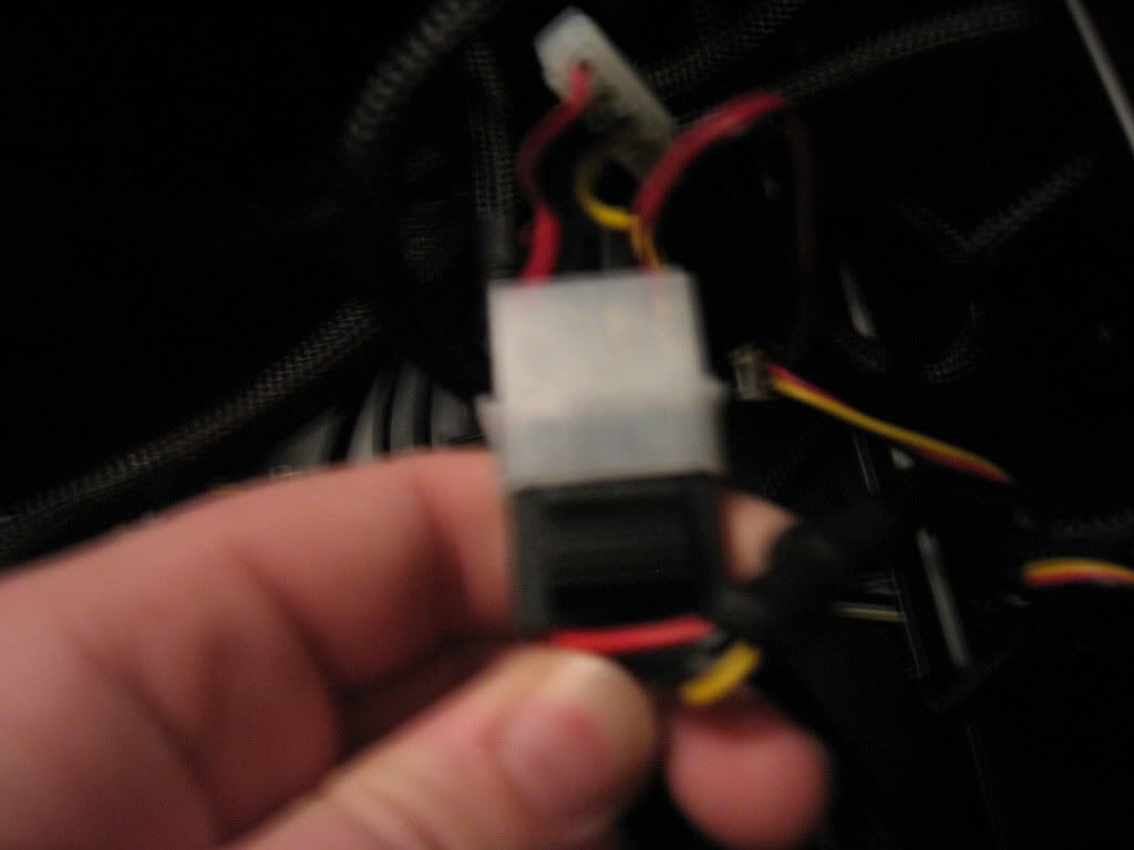

On the subject of cables, what are these things for?
http://i802.photobucket.com/albums/yy308/zachblaesi/IMG_0518.jpg
They're at the end of a long chain of connectors on some of my power supply cords. I wasn't sure what they are for. Newegg names most of the connectors on an image of my power supply, but not that one.

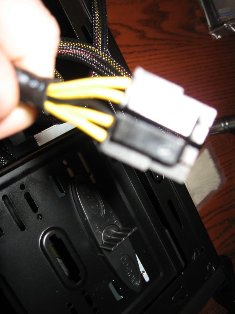

http://i802.photobucket.com/albums/yy308/zachblaesi/IMG_0505.jpg
I'm not sure where this thing is supposed to go. I'm pretty sure it's the eps12v. Is this optional? Because I don't see any room for it on my motherboard.

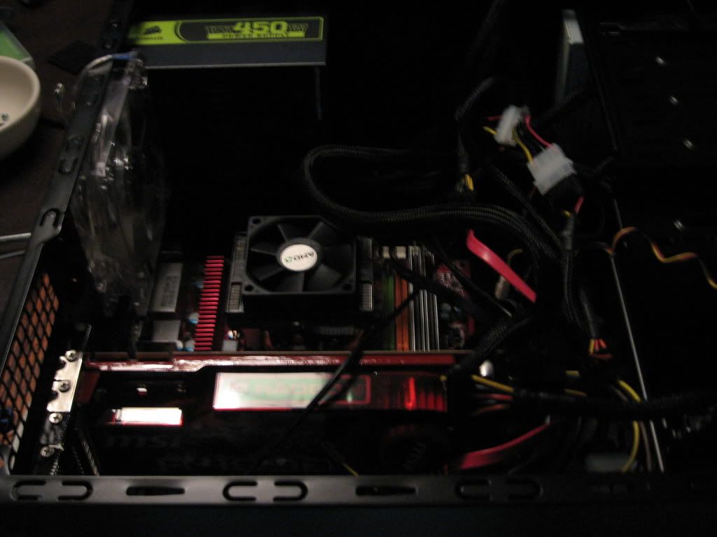

And just in case you notice I did anything else wrong, here's some pictures of the inside of my case:
http://i802.photobucket.com/albums/yy308/zachblaesi/IMG_0513-2.jpg
http://i802.photobucket.com/albums/yy308/zachblaesi/IMG_0513-1.jpg
http://i802.photobucket.com/albums/yy308/zachblaesi/IMG_0514.jpg

I'm sorry, but do to the cooropate filter I can't see the pictures you've posted. The only thing that I'd be worried about is making sure you installed the standoff's before installing your motherboard (little brass things that you screw into your case that your motherboard then screw into). This will greatly help make sure that you're not grounding your MB in a weird way.
Also make sure your using an outlet with a ground plug (3 prong). Other thant that you should be ok to try firing thigns up. It may not start up or work correctly but it shouldn't damage anything. Most plugs are shaped so that you cannot plug items into/with incompatible plugs.

Well Like i noted above I ufortinally can't see the pictures till i get home, but i'd think you'd be ok to try firing it up.
To answer your questions about some of your cable managment. Its always important to have the cleanest wiring setup for yoru case as possible. It will greatly help in keeping the air flowing through your case for cooling purposes. If you need to they make extenders for just about any sort of wire. I personaly like hiding most of my wires behind my motherboard (this depends on the case).

System Requirements: 500 Watt or greater power supply with two 75W 6-pin PCI Express power connectors recommended (600 Watt and four 6-pin connectors for ATI CrossFireX technology in dual mode)
Not sure the PSU will last you all that long, but, hopefully it will run.
