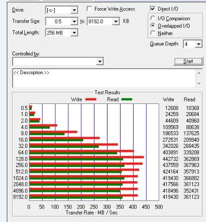

a c 143 G Storage
May 25, 2011 3:55:48 AM
Here is my ATTO screenshot, which if you look at the read speeds, they are pretty close to my CDM speeds (CDM is not 1/2 the speed, as it seems your is showing).

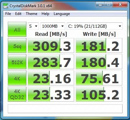

May 27, 2012 10:24:11 PM
I have a Kington hyperx thats supposed to be giving me 555read 510write based on Atto. Like the guy above I have the proper wire and sata port yet as you can see by my scores something is not right. I appreciate any help.
OS : Windows 7 Home Premium Edition SP1 [6.1 Build 7601] (x64)
