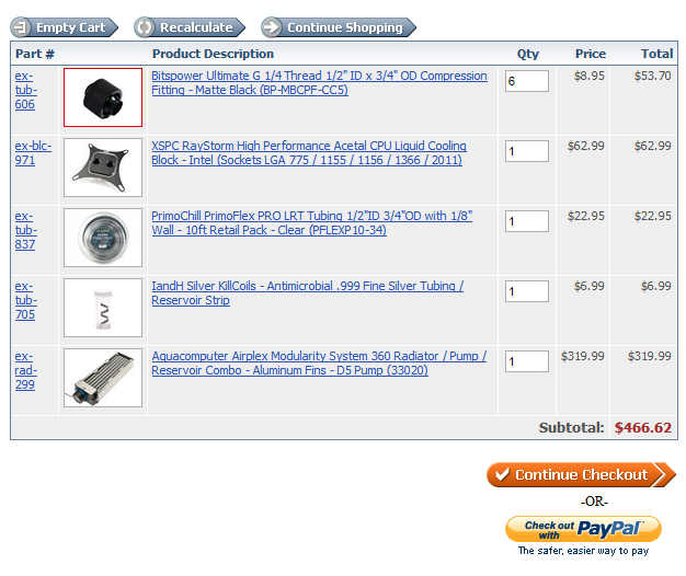

hey there everyone!
initially i was lethargic to post a thread but i'm following up on Rubix's advise to get the whole forum behind me on my new pseudo "2nd" watercooling endeavor.
this loop is for Rig 1 in member config, will cool NB as well using the Fusion block.
here's how it looks;
http://i908.photobucket.com/albums/ac288/Lutfij/WCloop3.png
the last two things (if it is two things) are:
1| fans and a
2| fan contoller
from most websites/threads the AQUACOMPUTER Airplex Modularity System Radiator has a fin density of 7 FPI : here
I am very discrete about noise as i like a quiet system...even when gaming. The silver lining for me, in my setup, should be to get a good temp drop without sacrificing silence.
Been reading on some German users that this rad is good with either a push or pull scenario.
so there you have it.
Purchase date: ASAP
Budget: will pay a ridiculous amount (ONLY) if its worth it
Preference's: Nosiblockers, Noctua, Scythe or any thing you folks would advise :sol:
Purchasing site's: if the prices are cheaper in places other than Frozencpu than ofcourse lemme have it...though the aquacomputers are the cheapest on frozencpu.
If any of you people are wondering why i named this my pseudo 2nd wc setup here's what i have now in my rig.
N.B:
1| I have a total of 8 fan headers on my board so i can control them via bios for a silent setup
2| I have a set of noctua's on my mod but i want to rule out my experience cos maybe it was the whole H50 thas flawed after doing that mod. Although the fans are dead silent...you get my point, right?
Thanks for taking the time!

how do these look?
Message edited by Lutfij on 11-01-2011 at 08:24:11 PM
------------------------------ WC'ing prjkt | Lutfi's AMS
WC'ing Sticky
Power Supply+UPS
PC Build Guide + Troubleshooting
Reply to Lutfij
52cfm @ 1000 rpm is pretty decent. If you are using these, would you even need a fan controller at 18db? For $10-$11, you also could go with some 1800rpm/70+cfm blowers and dial them down via controller; some of the guys around here like the Xigmatek's for about that cost...one has orange blades- the other, black.
