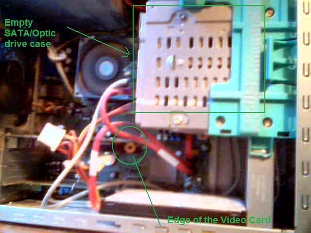

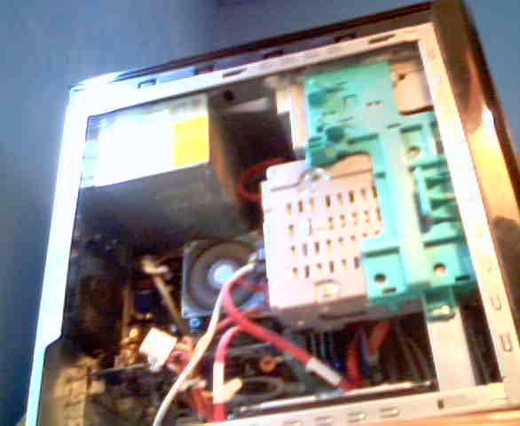

I didnt mention this earlier but I dont think i have room to fit anything longer than a 9" Graphics card in there, so if that card you mentioned is bigger than 9" it wont fit. also the speeds arent really BETTER on that card, just different really... i mean the shader and memory clock are less than HALF that of the GTS 250, and the core clocks are very similar. and frankly i just have bad impressions from the past with ATI cards(mostly pertaining to my friend having installed a fresh card, it blowing up, sending it back, getting a new one for a replacement and having that card just plain not even work out of the box. then when he finaly gets the third replacement card, and he has driver issues. i had to litteraly stop him from taking a wood-cutting ax to his computer.)
Another thing i didnt mention is that I have absolutely, not even the SLIGHTLEST intent on upgrading this Rig any mroe than a new GPU/PSU. EVERYTHING is so severely outdated that to upgrade it into a decent rig would cost more then buying brand new. All i want is to play Fallout3/Oblivion/The Witcher at MAX with MAX FPS (WoW was just sorta a benchmark, i dont really like WoW xD). Ill show you my comp right now:
http://h10010.www1.hp.com/wwpc/ca/ [...] 79614.html
Yes having actualy paid money for that system back when i was a LOT less educated about computers, i DO indeed want to scoop my eyes out with a melon-baller. Oh and i have 3GB of DDR2 400mhz RAM onboard so do you believe getting a 1GB card will bottleneck my computer? (The computer says it supports 4GB but like you said, there is a little room of Give-and-take)

http://i921.photobucket.com/albums/ad54/JeremyHill89/2009-09-1812-07-07533.jpg
http://i921.photobucket.com/albums/ad54/JeremyHill89/2009-09-1812-06-32472.jpg
If i CAN fit a card under that without changing the case im just gonna get the GTX 275 and pay the extra money. I may be wrong but not including SLI, as far as SINGLE cards go, GTX 275 is supposed to be pretty high up there right now, and should fufill my needs rather easily...as long as it fits -.-
Maybe i could remove that drive shell as i will never use that slot for a drive. Any opinions or help would be appreciated.

Hey Jeremy,
I'm not sure as to the actual length of the card, though i believe the 4870 and the GTS250 are roughly the same. You may want to do some google research on that. I would be more than happy to measure my GTS250, but i won't be home for a few days to see.

If you aren't using that empty drive case, i would make sure it does not add any structural support to the rest of the case, and check to see if it removes easy. If you have to take a dremel to it or anything then it isn't worth it.
If you are truly limited by space (which looks might be the case 8( ) you could look at these solutions. Sadly, they won't perform as well as the GTS250 but, they would be relatively close.

------------------------------ [:mousemonkey:1] http://img29.imageshack.us/img29/5041/vr2009champ.jpg
Reply to mousemonkey
mousemonkey wrote :
Without wanting to appear condescending, that's where you are best served exercising your powers of Google-Fu my friend.
Yes yes, google never lets us down apparently :P
Well thank you for the information :3
Reply to JeremyHill
