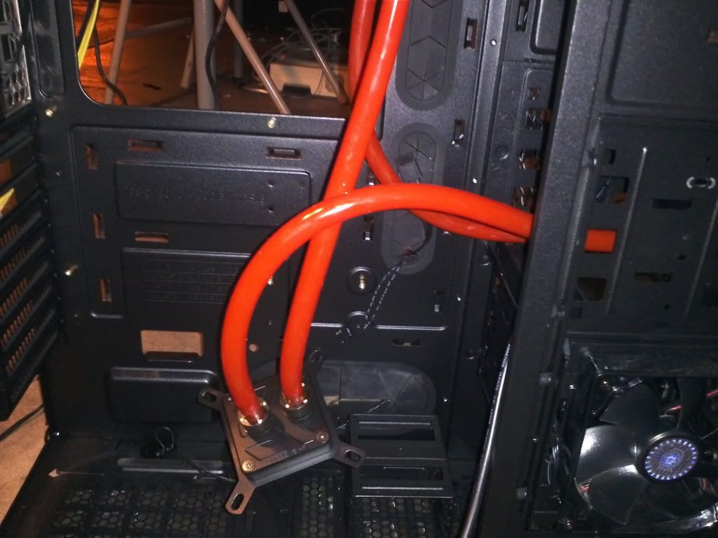

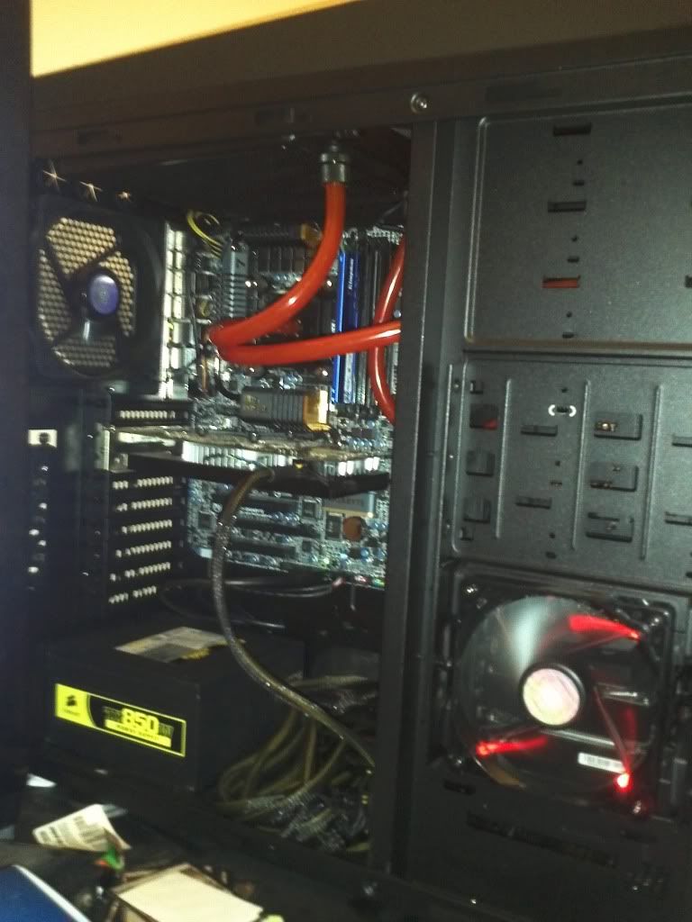

The parts!

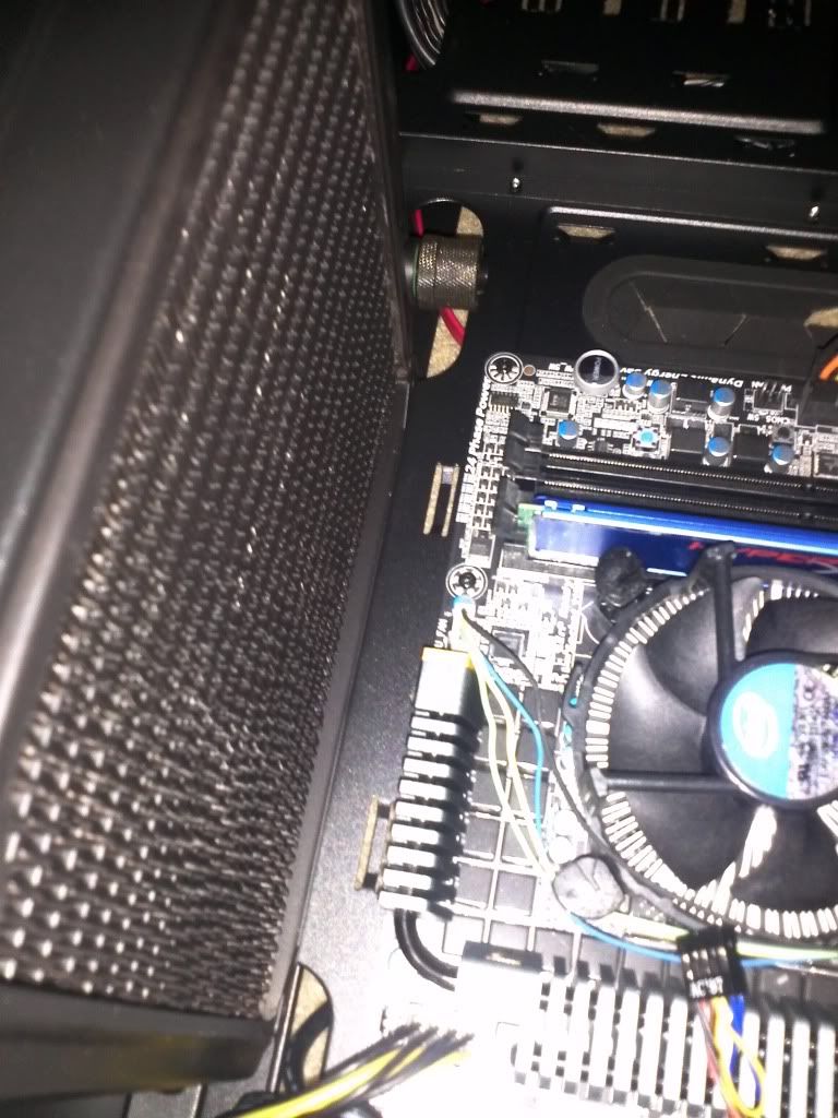

Leak tested in the case before I loaded the components it went perfect without a hitch!
Not enough space for rad/fan so had to mod the top of the case to fit it !!
*so note dont buy phobya was a pain the brackets were all messed up and it didnt fit so had to remove the handle and put the 200mm fan on top of the case inside the plastic covering for this case)

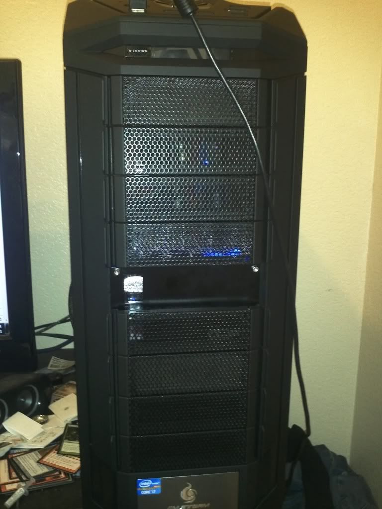

Completed!....for now

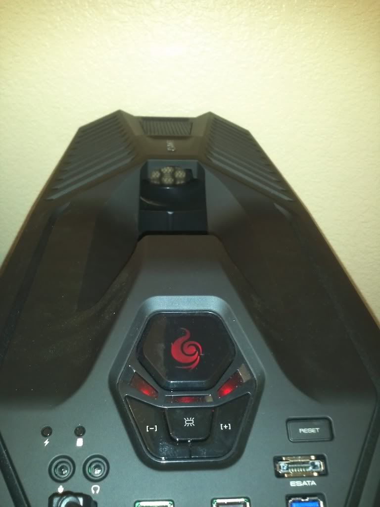

removed the handle off of the case and fit the 200mm under the cover (barely)
front image
First half of build done now just need tpo buy the new PSU and wait for the 7970's to be released!
