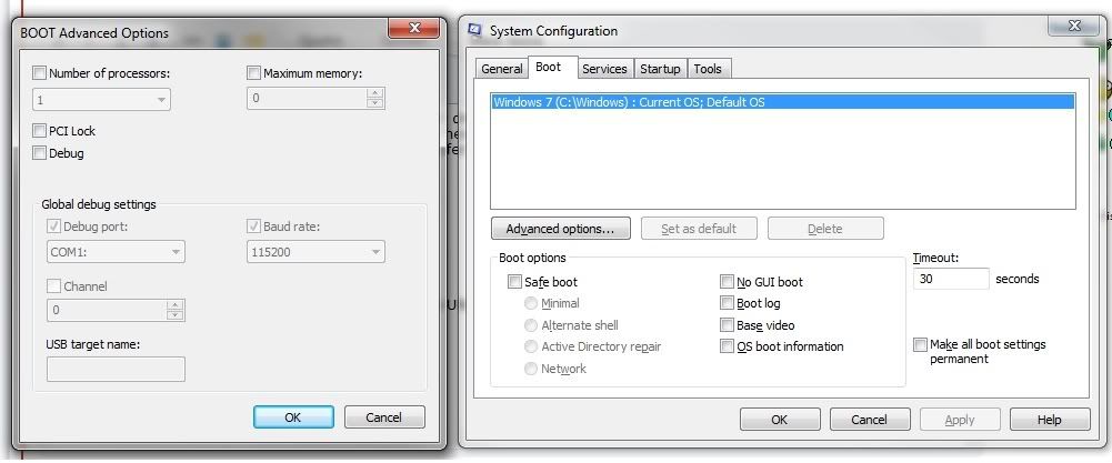

Did you check inside MSCONFIG?
1. Windows Key + R
2. MSCONFIG
3. Boot tab
4. Adv Options Button
5. then check if the "Number of Processor" option box is UNCHECKED
^Yea do that. If it's unchecked, try checking it and picking 4 cores. If it's checked already, uncheck it. Reboot to see if anything changed in the Task Manager each time.
Also, Phenom II CPUs will only report one unique temperature for the cores, and most software will display the same reading for every core all the time.
