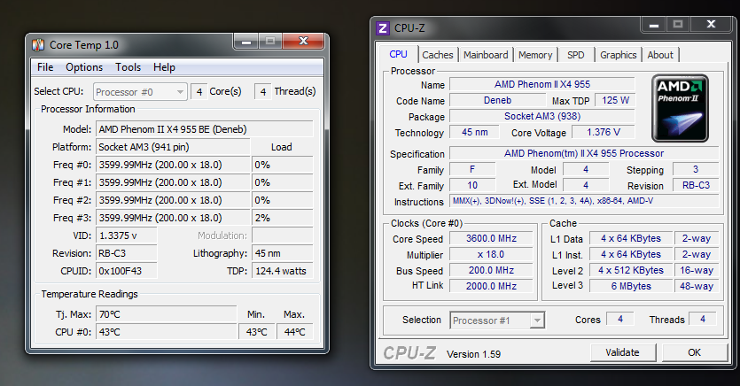

http://i39.tinypic.com/108d015.png
After tooling around with the BIOS, for more than an hour, I can seem to get the core voltage to stabilize. It's manually set to 1.35v, but still fluctuates between that and 1.384v. This motherboard is by no means "top end", so out of all the components, I'm trying to point the blame at something and it's falling on ASRock.

What you are seeing is called V-Droop. It is normal on almost all motherboards.
Only the very high end motherboards have circuitry to stop this from happening. It ia actually designed to function that way.

http://i693.photobucket.com/albums/vv293/waydiddy/currentoc.png
Funny you said that Rick...I was just tinkering and decided to drop by cpu voltage down another step to 1.335. My Core Temp shows the VID as the voltage I dropped it down to, and the cpu-z shows slightly fluctuating v-droop
Would it be wise to see how low it can go while staying stable? Is there similar dangers to undervolting as their is to overvolting?
Thanks Rick, I thought I was going crazy for a minute there

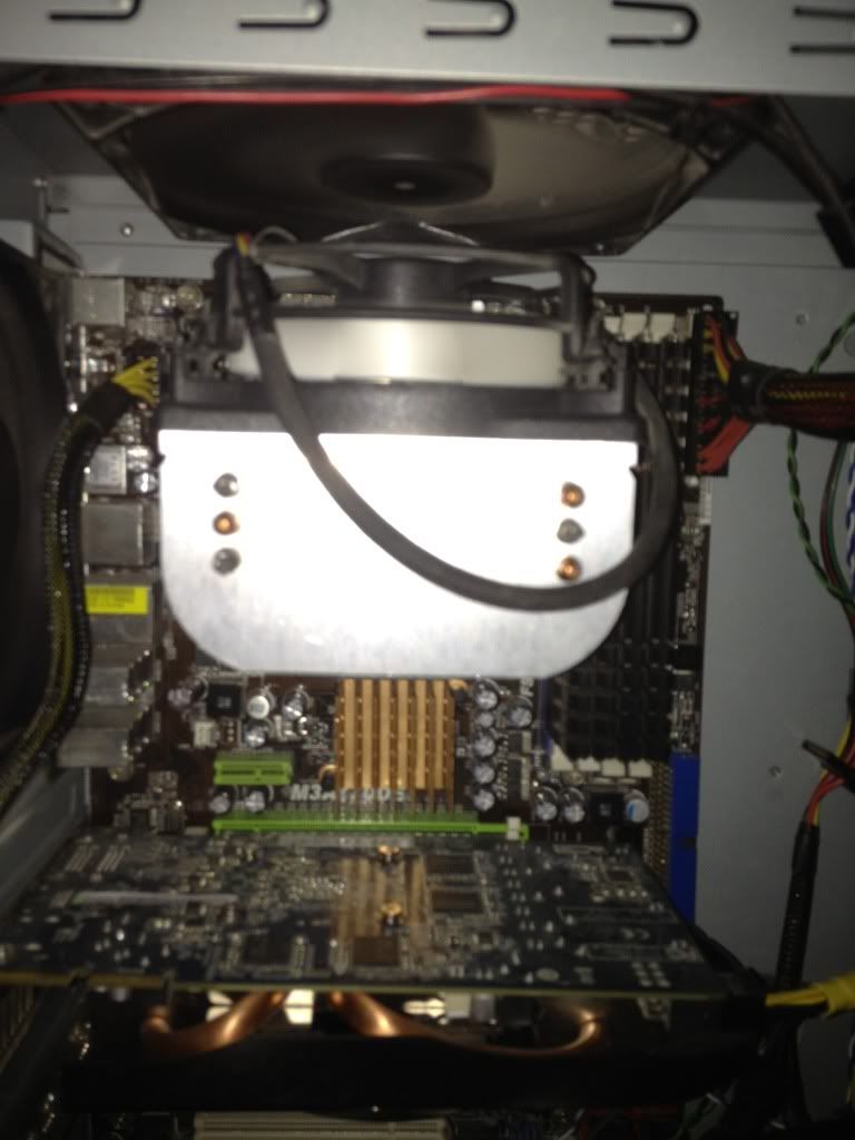

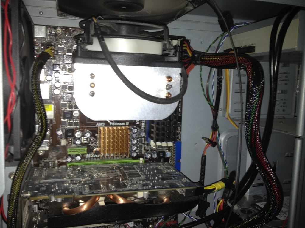

Sorry for the long delay on follow-up....
Here are some pictures of my set-up:
http://i693.photobucket.com/albums/vv293/waydiddy/IMG_0922.jpg
http://i693.photobucket.com/albums/vv293/waydiddy/IMG_0923.jpg
It doesn't feel like much air flow is pushed underneath the heatsink (towards the Radeon HD 5770 sitting below) and when I put my hand above, I 1.) nicked my finger on the top fan (ouch) and 2.) couldn't really tell what was going on
Can you tell from the pictures? Any suggestions on how to confirm the direction of the airflow?
Reply to waydiddy
Any final opinions? I know the topic has been sitting out there for a while, but I just wanted to make sure I'm running my CPU at the lowest temperature possible...
Thanks for any further input and all the comments up to this point!
Reply to waydiddy
From the pictures, it looks as if your top fan is exhausting and sitting directly over the processor fan. If this is the case, you are seriously hurting your cooling. If possible, I would rotate the CPU cooler so it is exhausting to the rear fan, 90 degrees clockwise, or you could simply unscrew the top fan and turn it over. This could, however, hurt overall performance as well dependent on airflow. If you are pulling more air into the system than you are exhausting you are creating a "positive" pressure cooling environment which is less effective than a "negative" pressure cooling system. The concept is to push more air out of your system than you take in. I.e. more exhaust fans than intake fans.
I personally think the best solution would be rotating the CPU cooler if possible.
Reply to Puff3r
Thank you for the response
I'll take a look at the different orientations of the CPU cooler closer when I get a minute. If memory serves me right, I believe the way the bracket is designed for the motherboard, I only have the option of keeping the fan where it currently is (facing upward) or facing downward.
I definitely will take into account your advice. The first thing I'm doing when I get home is flipping the side-mounted fan from intake to exhaust, creating that "negative" pressure you were talking about
Reply to waydiddy
