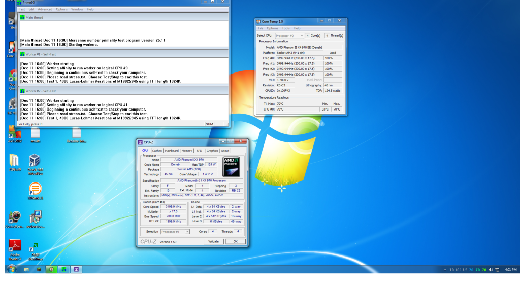

My Phenom II x4 970 climbs up passed 70 degrees under load @ stock speeds and keeps going up until I stop it or let it crash! And that is with 2 fans in push/pull! There is obviously something wrong.

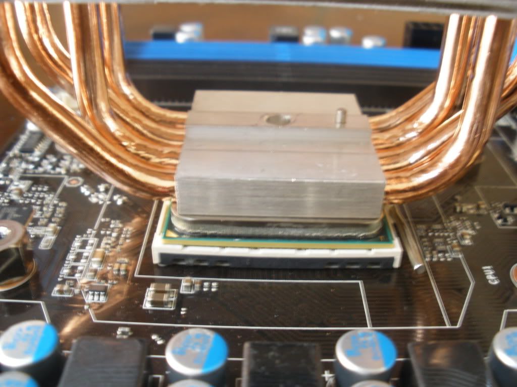

The third pipe(in focus) is definitely damaged(bulged).
That's absolutely a defective product.
A pipe in that condition is unusable in my industry.(hvac)

My CPU was at 70 degrees after a minute of Prime95 with my fans on 100% at stock speed and voltage. Still WAY hotter than the stock cooler...

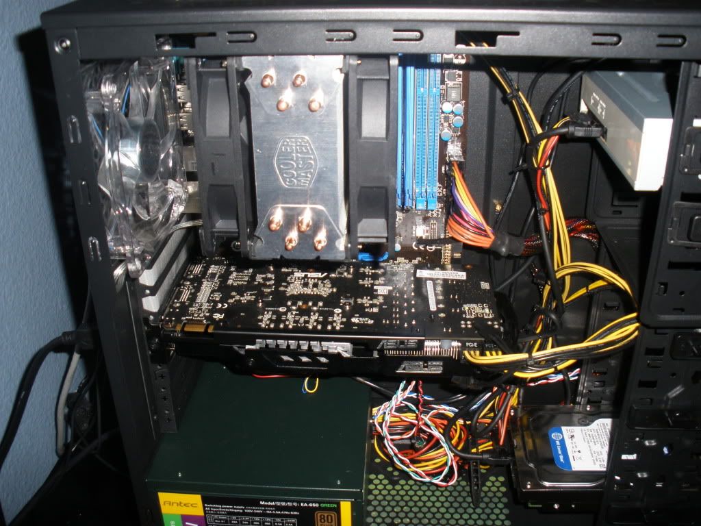

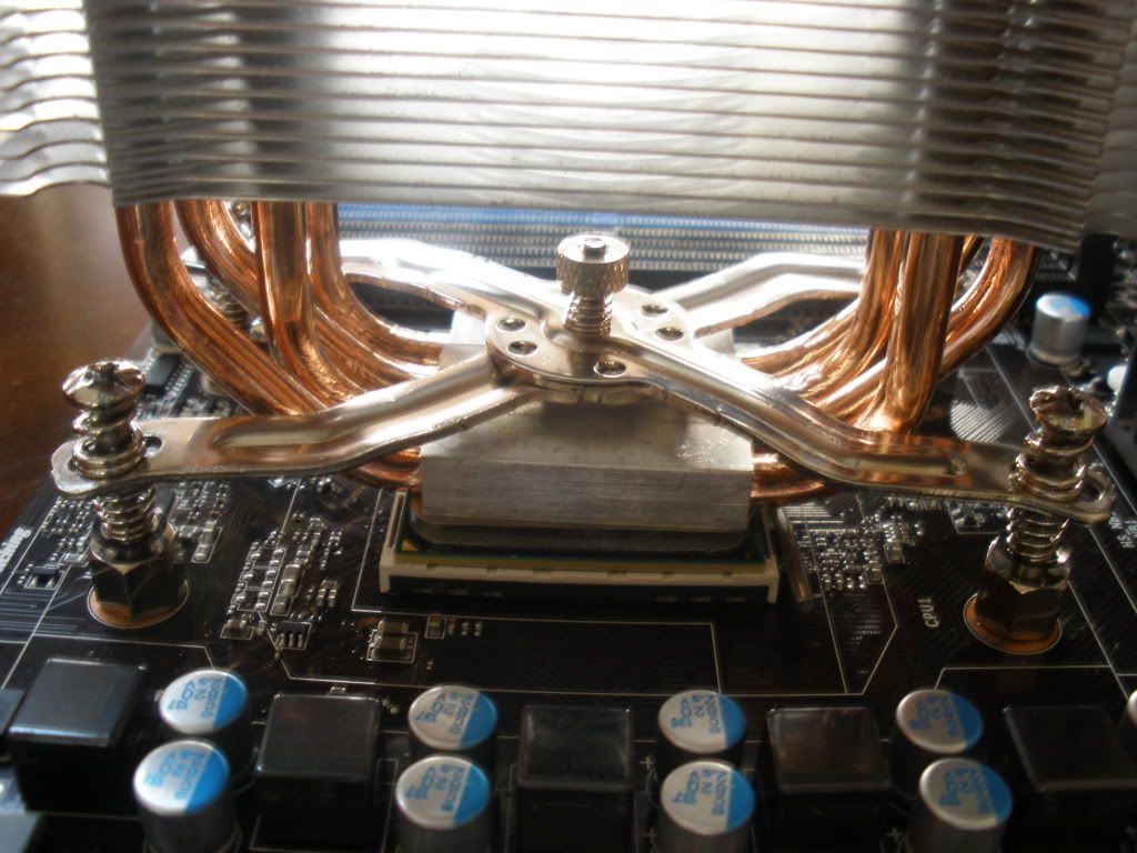

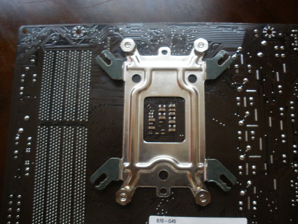

I took some pictures of my mounting procedure- please notify me if it is wrong in any way or you spot something wrong with the hardware. Thank you.
Also I can hear my fans running and I can feel them pushing quite a bit of air and the BIOS says they are running at 2000RPM, so I don't think it's the fans.

Yeah, the nuts are nice and tight and I tighten them in a criss-cross pattern.

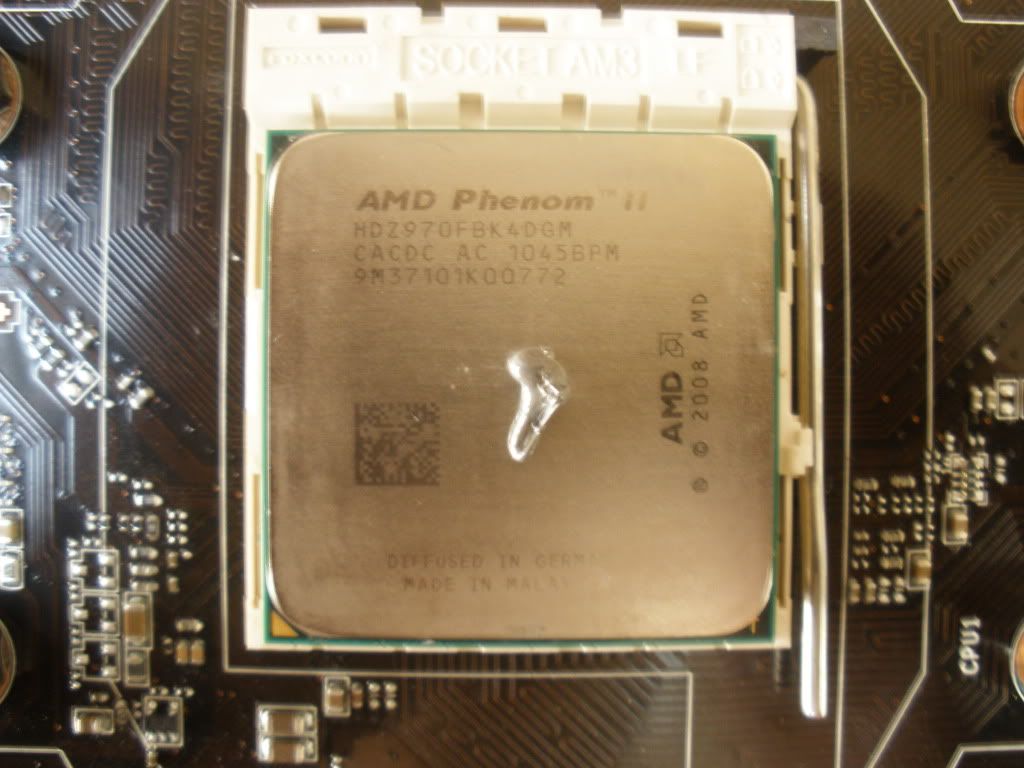

I tried this technique before and still got the same temps. I definitely used more that time than in the picture I included in my previous post. When I removed the heat sink, it was spread out across the heat spreader, so I don't think it is an issue with the paste.
Just tried that but to no avail. I spread it out very thinly across the heat spreader. It was actually easy than I thought it would be to get it spread evenly. But still I hit 71 degrees in prime95 in under a minute.
Still no answer...I just want my CPU to be able to perform without overheating. When it is running, the air coming off and the fins do not feel hot. That probably has something to do with it, whatever the problem is.
Two lines is now the new pea method due to 2/4 cores in place of 1
Oh also as far as tightening be 100% sure to spin the centre screw
crank for crank

Yes I do have other issues. However its not actually running at 1.432. CPU-Z seems to be a little inaccurate. In the picture you can see that CoreTemp shows 1.4v and AMD Overdrive gives me the same reading. The BIOS is all at the stock settings except my RAM is clocked at 1600 (what it is rated for), AMD Cool n' Quiet is enabled and the fans are set so they are running at top speed.

I think I know what the problem is. I think the heatpipes are messed up...
They look warped. This is definitely not normal. This must be the source of the bad conductance. Is it possible that they were damaged somehow and now there is a small crack or hole somewhere that compromises the cooling ability? That would probably explain some things. Maybe it happened during shipping because I have gotten these temps since the first time I mounted it.

If the pipe has been twisted, that could only mean a manufacturing issue, correct? I don't see how else that could happen. If it was from the manufacturer that way then I am under warranty, so it shouldn't be a problem.
