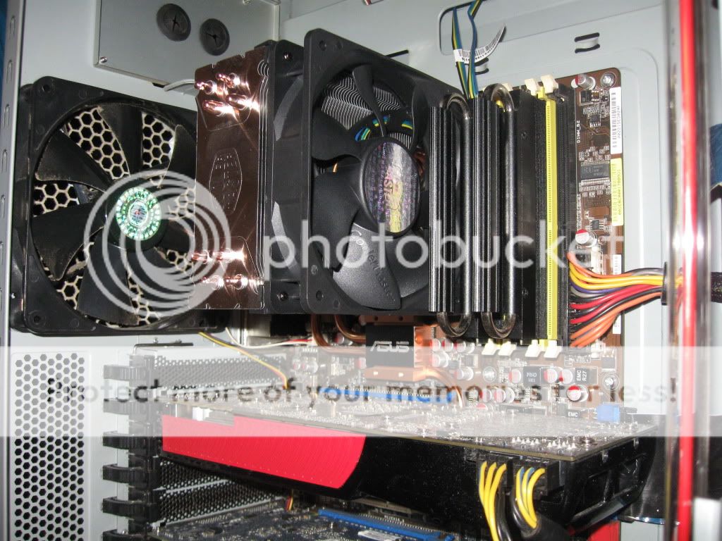

IMHO, it sounds like a sensor error. Although when I first got the same board I was running at 46c Idle and 52C load (max according to spec. is 55c). So I added the fan from this http://www.newegg.com/Product/Product.aspx?Item=N82E168... and brought down temps. 6c to 38c idle and 46c load.
Note: I did not use the Coolmax heatsink, just the fan. I could only use 2 screws (which I purchase at the local hardware store) to mount it, but it fits tight, as seen here

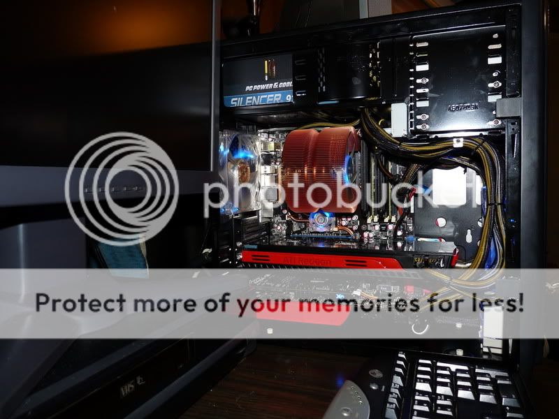

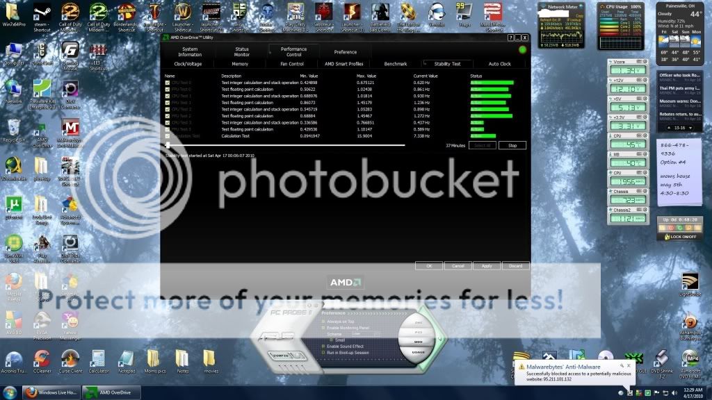

April 20, 2010 5:56:57 AM
Hey fester,
right stacking heat sinks may not be ideal, but i am not sure how it would be defeating the purpose sense its still copper on copper. and would still do more good then bad. But i just installed a new CPU fan and would only seem complete to install the heat sink for the north bridge as well. i will be ordering the heat sink soon and ill post the results and let you know if or how hard it is to mount. Also i just updated bios to 1501 from 13somthing and my north bridge is reading 37 idle ATM. but i am dedicated to see what that does for me. also overclocking AMD Phenom II x4 940 Deneb 3.51Ghz, sense putting the new heat sink on and it seemed to help move more air away from the chip set to help cool it.
Temps at full load with 3.51GHz

April 22, 2010 10:23:13 AM
i should have mentioned the day i took that pic it was about 40F in Ohio and my window was open right next to the PC.. although the temps have dropped on both CPU and NB after installing new cooler.. they where hitting low 50s and that's what concerned me.. Summer is coming up and im not going to stop using my PC because of temps. So this is a desperate move. I ordered it tonight ill post pics and screens of any improvement. anyways im buying it from newegg so as long as i don't demolish the hell outta it i can return it.. you have any other suggestions.. was thinking maybe a antec spot cooler, if this fails.
