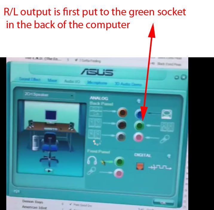

To put it shorty, it didn't work...
but I made this video with my iPhone really fast... it might help a bit more....
http://www.youtube.com/watch?v=c1PmfHVoMOs
might be hard to see, but try watching in HD. Sorry, I had to record with my iphone.
*Edit* wow, looking at YouTube, I'm not the only one with this problem... Realtek needs to get their products working.
Now That is a reply. It all looks good except your headphones need to be plugged into the mainboard green socket. The Realtek Audio Manager should pop up when you unplug them from where they are to warn you something just got unplugged. Plug into the green socket and it will again warn you something just got plugged in and it will have many choices for you to select what just got plugged in. Check the box for Headphones or Line Out.
Realtek for all their wizardry, auto-mapping, auto configuring just hasn't got that front speaker thing perfected yet. If you have more than 2 channels, green is Front and the rear goes in the orange socket for best results. I use Klipsch Promedia 4.1 speakers with my own bass speaker and this works well for me using the green and orange sockets.

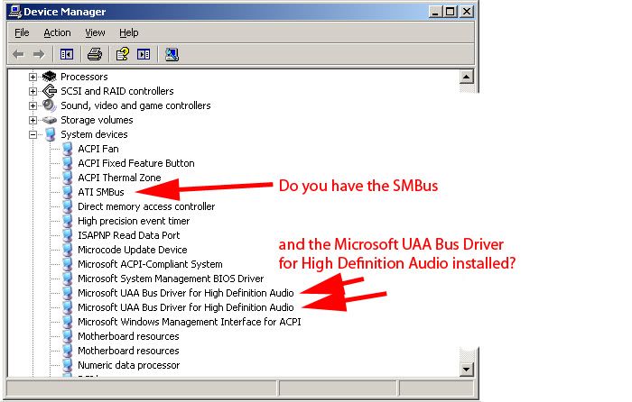

Ok, look in Device Manager expanding System Devices and look for the SMBus and the Microsoft UAA driver as pictured below.
The SMBus is part of your chipset drivers. It wont necessarily be ATI, it will be from the chipset mfg.
The Microsoft UAA driver is
HERE. If you are using SP3 then it should be already installed.

Thanks a lot tigsounds yet again, but unfortunately, still nothing.
Both the SMBus and the UAA driver showed up in the device manager, but I went ahead and downloaded it from the link anyway, which didn't make a difference, unfortunately.
However, some good news... when I plugged the earbuds into the green socket and held them to my ear with music playing, I can't hear music, but I do hear background static, which is a first.
