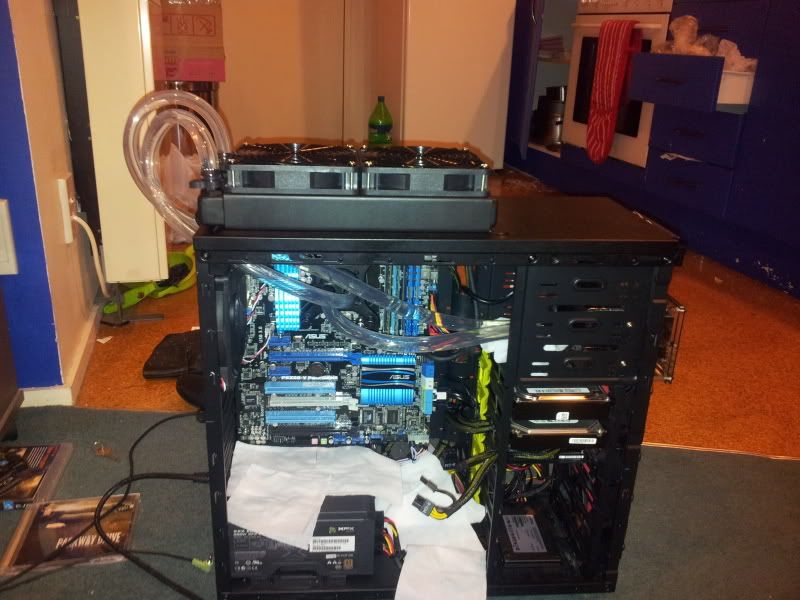

hey moto. turns out i WAS just retarded. the rad screws for some reason were separate to all the others in a tiny piece of folded card. everything is installed now.
when i first filled it up, i had a minor leak because one of the barbs wasn't attached tightly. panicked, but a little twist and it seems to be fine now. everything is actually in the system now, and im not comfortable leaving it out of my sight while i leak test. ill let it go for a few hours, and as long as there are no other leaks ill turn it off tonight and resume in the morning.
there are lots of small bubbles trapped against the walls of the tubing though. and no ammount of tapping seems to shift them. any tips?
EDIT: here's a pic:
since i already have the mobo powered, i may put the gpu back inand hook it up to my monitor in a sec. resume leak testing while its hooked up. kinda defeats the point i guess, but i cant remove it all now.

You did rinse the tubing (as well as all other components) out before installing I assume?
Just a case of wait tap, tap, tap cry wait tap I'm afraid, try rotating the case as much as you can, make sure res and everything is secure though first :-)

Yeah, most of the bubbles have gone now. I think there were so many because of the leak i had caused the pump to push a lot of air through the loop at first.
looking much better now, although the mounting was a bitch and i had to resort to externally mounting the rad.
For now I'm just using distilled water as i couldn't get hold of any anti-microbial. When i get a hold of some should i just drop it straight in, or bleed and rinse it first?
Also, im assuming i don't need an anti-corrosive as everything in the rasa kit is copper?
lastly, a questions about positive air pressure. at present those top fans are acting as exhausts, and im wanting to switch them to better cool the rad. Should i switch both to intakes, as well as the rear exhaust, and then switch the front intakes to exhausts?
Or would it be okay to have just the one exhaust with the rest as intakes? I'm assuming that buildup of positive pressure wouldn't help, but can't find a definitive answer.
I also have a side panel 120mm hole which i may populate to blow cool air to the GPU.

a c 205 K Overclocking
March 7, 2012 5:02:13 PM
If you do get some Pt nuke or other algae killing gloop, just put the recommended amount (1-3drops?) into the loop, no need to flush the whole loop unless you wanted to for practice maybe :p
I always say additives are builders choice, I run water and a coil no additives (I do have UV cathodes on two of my resses though)
If you want to swap the fans, how about mounting the fans inside the case blowing out, and the rad on top, fans push through the rad on the way out and you can add two more on top later if/when you wanted to
keep the front as intake, and don't worry about the sidepanel until you have some reference temps to work from
how else would you know if the sidepanel change was effective? :)

I can't really put anything on the inside cause this case ins't as well designed as i had thought (in fact, i may replace it soon).
the water tubing holes and the mobo 8 pin, and cpu fan connectors would be obstructed if i install anything internally. I could however install a couple of slim fans internally. Nut from what i understand, having low power fans inside and higher power ones outside creates too much static pressure? which is bad?
I had already considered removing some of the mesh paneling. But another weird drawback on this case is that the top mesh mounting holes dont actually line up with a 120mm rad. so i'd have to only cut part of it.
