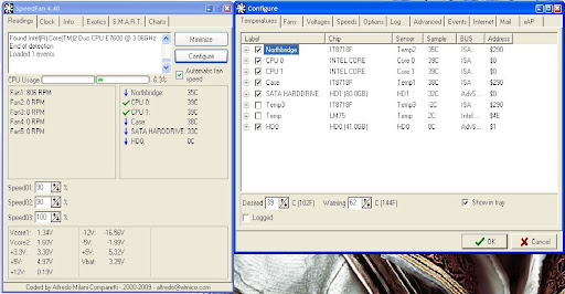

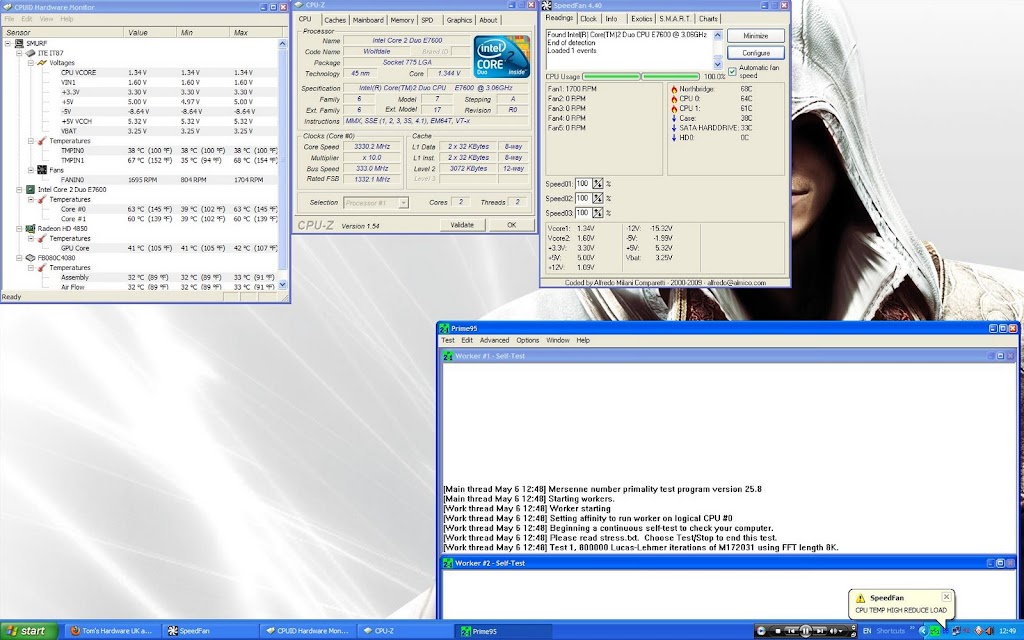

Just a question inquiring about a SpeedFan (Latest Version) Issue that i have noticed.
My GA-EP43T-UD3L Rev 1.0 (Bios Version F5) Seems To have a Temp issue On one of the sensors.
During stability testing (3.33Ghz Intel E7600 & GB Samsung RAM 8-8-8-22 (CPU-Z) (333 x 10 FSB : DRAM 1:2)) I am getting a Temperature warning from the MOBO's Speaker Which is set to go off @ 70'C :(
The interesting thing is that its not the core temps setting it off, its some other Mobo Sensor IT8718 Which I have Labeled North bridge. as you can imagine this has gotten me Rather Frustrated. Core temps are stable, voltages are stable but the MOBO is whacking out. :pfff:
Screen shots Click to enlarge images
http://lh6.ggpht.com/_c2uudiKHthA/S-KhRfkuGeI/AAAAAAAAAEk/mNZy46hi8Xc/SpeedFan1.jpg
http://lh4.ggpht.com/_c2uudiKHthA/S-KhZ7sCY0I/AAAAAAAAAEs/ez8J3W_UPco/s1024/Speedfan2.jpg

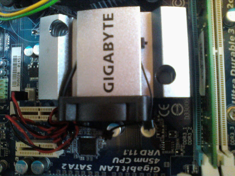

I tried To bring down Temps By attaching A 45mm Fan to the NB With no avail, it is Pulling Air through the NB
http://lh4.ggpht.com/_c2uudiKHthA/S-KhZOyRTpI/AAAAAAAAAEo/9CGuwCht50k/s800/Speedfan3.jpg
Anybody have any ideas on what this temp Reading is Actually Representing?
Why is it so high? And is there anything i can do (Besides Water cooling) To cool it down?
Thank you in advance
PS. What is TJ MAX? :heink:
The IT8718 is the board's LPCIO chip (low pin count input/output), and is responsible for a huge number of funtions, among which are 'off-CPU' temperature measurements, floppy operation, fan control, PS2 kbd/rodent hook-up, com ports, and on and on... We ( use the 'royal' we - meaning I, nor anyone I know) don't know the exact position of the sensor - the closest we've been able to determine is "somewhere above the right end of the primary PCIeX16 slot, which puts it near or under the northbridge"... Here is something pertinent from GB tech:

Hmmm - odd, very odd. Try having a look at this: your northbridge sink is the big one, right next to your CPU. It is held in place by a pair of 'spread-pins' that snap through the board, and underneath the top 'heads' of the pins should be a couple little springs - try to get a look at 'em (dental mirror might help...) and see if either one looks damaged, and whether the sink itself is 'down' squarely on the bridge itself... You're only running two dimms, and they should be 'installing' (LoadOpt) at the stock JEDEC 1.8 - shouldn't be enough to run the bridge very hot, but your symptoms are exactly what happens when overclocking/overvolting a bridge (say, 4 DIMMs @ 2.1V and 1066) - runs OK 'till you 'push it'... I'm wondering if somehow the sink isn't being held in flat, complete contact with the bridge's thermal surface? Next step, my guess, might be to pull the sink (by carefully 'squeezing' the bottoms of the pins to release them [and be careful! don't let the eetsy-beetsy springs fly off into the room - or you'll be crawling on the floor for three hours - ask me how I know :pt1cable: ] with a needle-nose...) to get a look at the thermal pad beneath... I always pull 'em, toss the thermal pads, lap the sinks, and use TIM paste on 'em, but then you've got to replace the pins with some nylon 4-40 screws, as the 'stack height' is smaller with the pad gone...
I'm taking you meant this post?
it Makes sense to me, it did seem to be on a little loose when i was attaching the 45mm fan.
i didn't check the pins, i just pushed down the cooler firmly and used a jewlers screwdriver to apply pressure to the center of the pins located inside the cooler with no effect
I would re-seat the cooler but as my general rule I only re-seat any cooling component with Fresh TIM. Since the only TIM i have at the moment is uber expensive HP server solution enterprise grade stuff, I'm kind of stuck... :(
Do you thing Lapping the NB would really decrease temps that much?

Nah - lapping is only good for a couple degrees; I just do it 'cause I'm freaking obsessive [:fixitbil:9]
I'm mainly suspicious of 'thermal pads'; twice now (never on a GB board BTW) I've found 'pad problems' with 'misbehaving' graphics cards; once, had a totally missing pad on a voltage regulator; second time, found a pad 'folded over' diagonally on a VRAM chip, which caused enough of a 'stack height' problem to cause the sink to not contact the row for about two chips in either direction...
Now that I've seen some VidCard cooling 'oopses', I'm scanning the news daily, waiting for the first heatsink failure on an nVidia GTX-480 to cause a 'China Syndrome'-type 'meltdown', and take a small neighborhood with it into a molten hole in the ground [:bilbat:9]
I also have some concerns about the mounting 'hold-down' springs. Some years back, I did a high-speed assembly machine that made neon sign tube mounts. They are a little gizmo, sort of like a shock-absorber, that have a spring-loaded plunger with a u-shaped clip on the plunger end to hold the neon tube, and an oval base with a mounting hole on the body of the tube to screw it onto the sign's frame. We used a couple vibratory feeders to supply the springs to the 'inserter' station, and had to add a few 'sortation' stops to the feeders to 'intercept' malformed springs - and never were able to 'catch' the perfectly straight, but incompletely formed (my assumption - the 'spring wrapper' ran out of wire part way through) ones - if I recall correctly, we had about a one in five or ten thousand failure rate. Now, GB may 'squat-down' harder on their suppliers for QC, or, in an application like that, it may be worthwhile to do automated optical inspection of each piece - but my main workstation board has (had) ten of these babies - if one in ten thousand is 'malformed', it would mean every thousandth board has a loose sink corner somewhere[:fixitbil]
As far as TIM goes, I usually recommend TIM Consultants' T-C Grease™ 0098, which can be ordered here, and is reviewed here. In case you don't want to be bothered to read the whole 'comparo', the trick to the stuff is that it's 'thixotropic', i.e., it becomes less viscous when shear forces are applied, so when you 'wiggle' the sink down into place, the stuff flows out better. Not particlarly expensive, and the thing that got me was that they threw it in a padded envelope, mailed it to me, and charged, like, a buck and a half, or two and a half for shipping! None of the usual "put it in a protective tube, and blister pack the tube, and put the blister pack into a box with a bunch of advertising crap on it, and wrap that box in bubble wrap and throw it into a larger UPS box, and charge more for shipping than the stuff cost in the first place!!" [:boudy]
