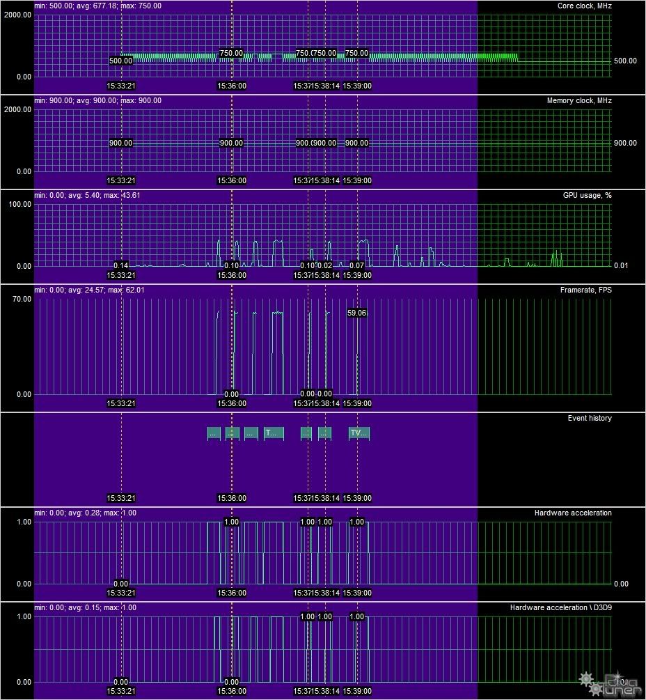

I caught this. I tried to reproduce it but no luck. But this is how it acts in game everytime. with Vsync on. With vsync off it plays a lot better but the micro stutter our there.
http://i992.photobucket.com/albums/af50/jeffd10/th_HardwareMonitoring.jpg
http://i992.photobucket.com/albums/af50/jeffd10/HardwareMonitoring.jpg
Reply to jeffd10

Looking at the graph you would think i started and stopped the game several times.
