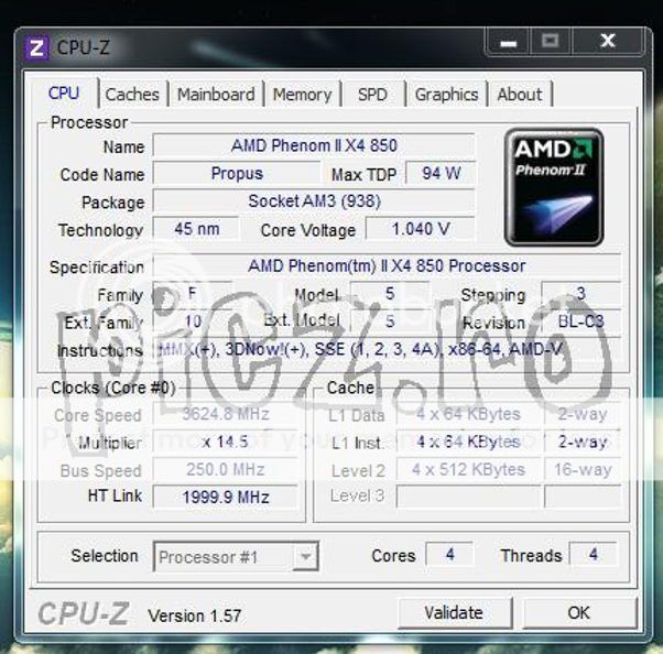

    i put all u write in bios now is working but still my ddr is on 1666Mhz and my proc runs at 3250Mhz
    what should i do now .... here are picz hope u can see them clearly.
    Thanks

  18. http://picz.ro/index.php?id=57f7b754350ce1f4a516dd05ad5deaff
    so thats ok ? my voltage is on auto right now ... because i dont get witch one i have to change .... what i have to do more ?
  19. I don't know what you did or how you ended up where you are. If it's working and you like it, I wouldn't touch anything, but I have difficulty imagining your system as stable (though it may well be).
    3.625GHz at 1.04v, I suspect, is incorrect. You should check your cpu voltage with other utilities. You have not reported your operating temperatures. You have not verified that your Backup BIOS is the same version as your Main BIOS.
    Presumably, your RAMs are running 6.67x250-1667MHz. Did you raise the IMC/NB from 9x to 10x?
    http://i716.photobucket.com/albums/ww165/Back_at_the_Ranch/AMD%20Overlords/Stuff/6fb.jpg
    Otherwise,
    You can try your CPU 15x (= 3.75GHz) The maximum CPU multiplier on your chip is 16.5, or 4.125GHz. Your ability to reach that speed, once again, is dependent upon your temps, voltages and stability.
    Good luck!

    Please carefully re-read the thread for tips on OC'ing your rig. The CPU multiplier at stock is 16.5x200MHz, and will operate at any level below that multiplier in *.5* increments. It is 'locked' from going higher than 16.5, not a lower CPU multiplier.
    At last report the OP is running 14.5x250MHz, 3.63GHz, with his RAMs at 6.67x250MHz-1667MHz.
