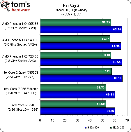

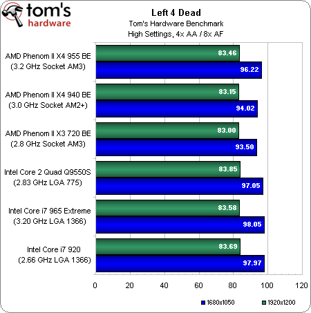

December 2, 2009 1:06:54 PM
Nope there is nothing wrong with the chip - just use other encoding apps to take full advantage of cores ^^
http://www.sharkyextreme.com/hardware/cpu/article.php/3...
In the meantime for the sakes of comparison:
720BE vs the highest end desktop chips out there for gaming
Then we see how how minor L3 hurts the baby tricores i.e the Ranas when placed toe to toe with Heka
The final nail for me comes at GTA4 where a high end OCed dual core is absolutely worked to the ground - so no go for dual cores for me if starting a new build hehe This with some prrety dated quads too!
It becomes apparent that at $76 and with this architecture being by far the most clockable chips AMD has put out EVER the Rana X3 425 is an outstanding entry level gaming chip hehe If you could afford it the 620 Propus for the budget end king :p
