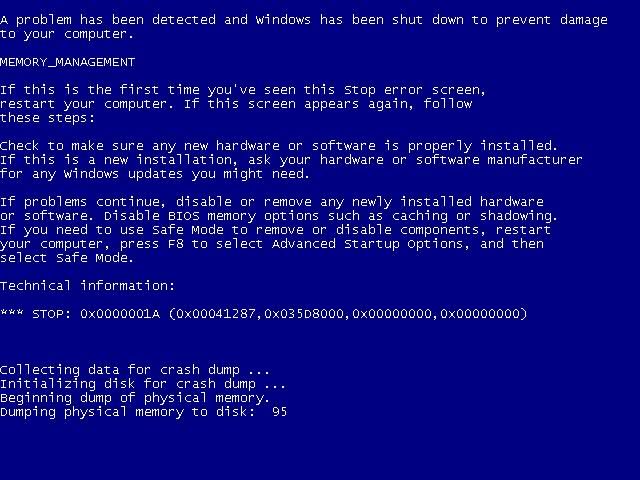

I am having some wierd crashes with my new rig. Here is a picture of the screen when it crashes, Pic of my screen when it crash

th crash is really bizarre, my screen goes like the picture in the link i posted and it automatically reboot. I need to do nothing, but for when i watch streaming video in full screen i have to manually restart cause even ctrl+alt+del dosent work. For psu voltage problem i would really be surprised cause my dad know did checked every connector with a voltmeter and everything was fine. The voltage were spot on. So that mean if it is a voltage problem it would be the card or the mottherboard ?

and you get the same image as the one i posted a link of when it crash ?
Reply to snorojr
yeah, but it doesn't get stuck on that image, just for a second and than the PC crashes and reboots.

I ran memtest and my RAM is fine, no errors at all. :( mobo it is.
Reply to bazylik
