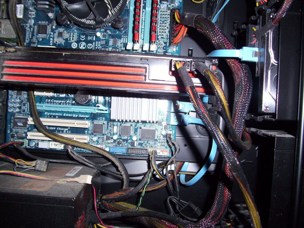

What do you mean by 6 intel ports and Marvell ports? This is what my sata ports look like:
(there are some underneath my GPU)
I have 8 SATA ports on my mobo all together. the first 4 are SATA 2 ports and the next two are SATA 3.0 ports. The last two ports are for a RAID array.
So are you guys saying that if i install an SSD into my SATA 3 ports i will need to change something in my registry?
