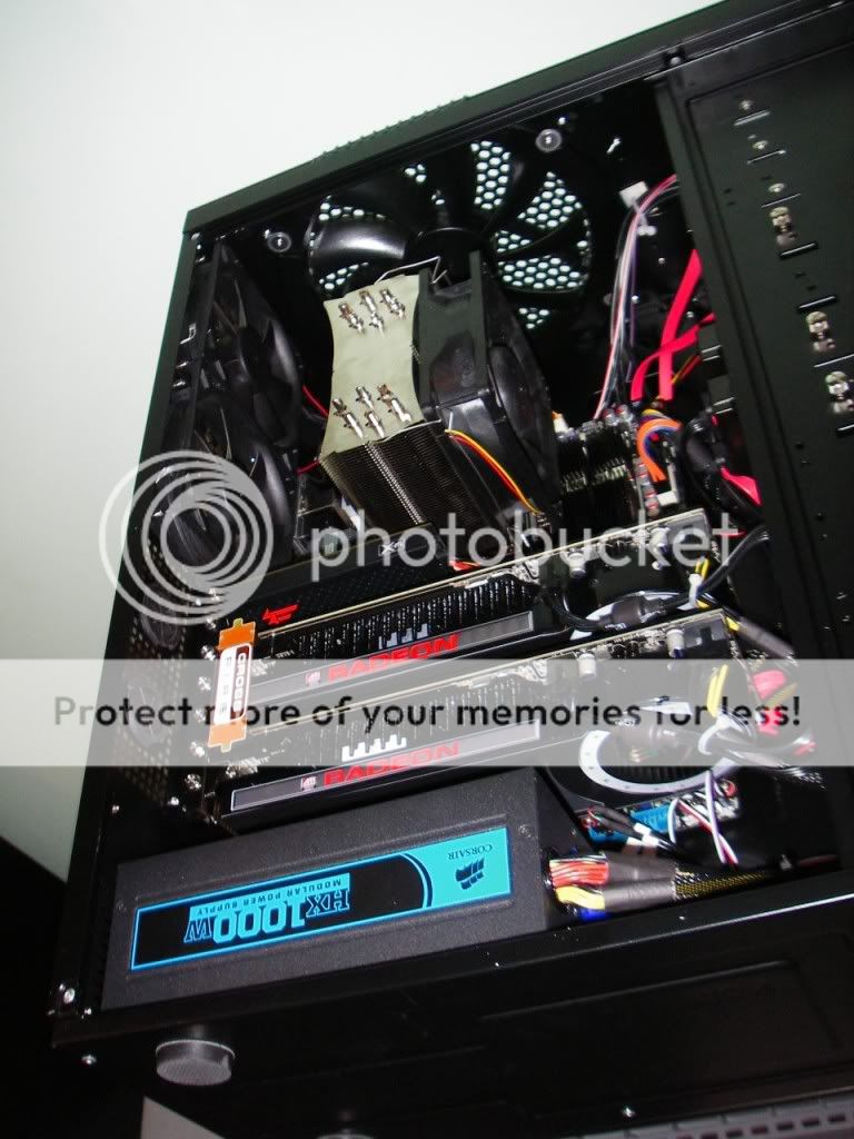

Well you really don't need a 1,500w PSU, that would be overkill but that 1,200w should be more than enough. Try getting a 1,000w if you can find one, if not whatever fits your budget. Just make sure you get at least a 1,000w just to be on the safe side.
a good 1000 watts will power 2 4870x2's
enermax 1050 watts
corsair hx1000(you could chance the hx 850 since they pulled over a 1000 watts from it)
corsair tx 950
ocz 1000 watts
pc power and cooling 1000 watts
bfg 1000 watts
Cooler Master Silent Pro M1000
Silverstone OP1000-P 1000W
Hiper M1000 1kW
NorthQ Giant Reactor 1000W
Seventeam Thundering 1000W
