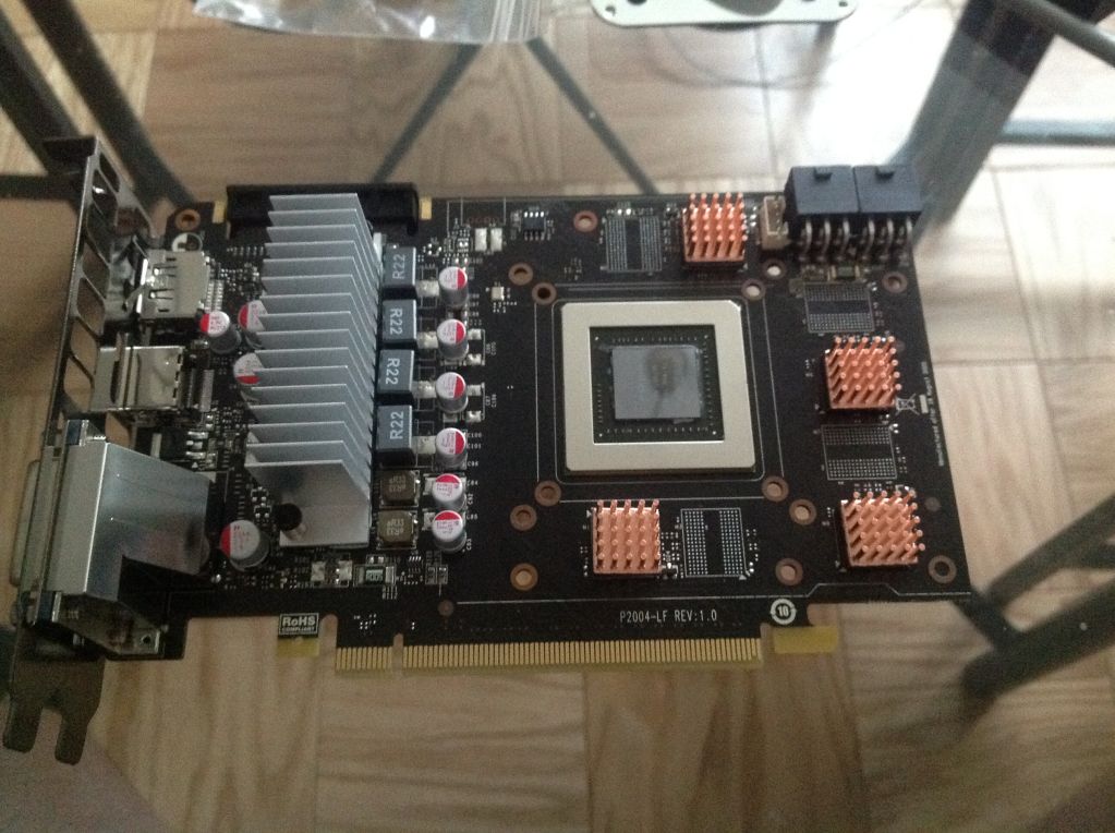

Alright, so I got my GT400 Rev. 2 bracket and my heatsinks today (from two different places to boot!) and got everything mounted.
I was hoping to simply just change the bracket on the MCW82, but I forgot that the screws in it held the block together. Sure enough, I ended up with a puddle on the floor (got most of it into a bucket though).

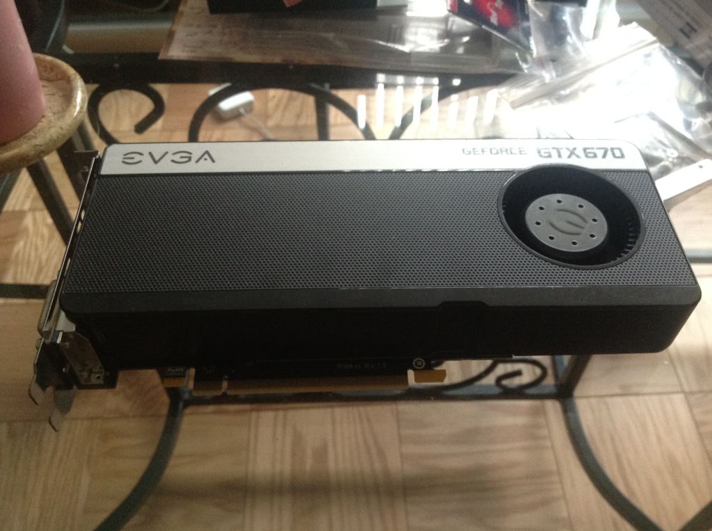

Here's the awesome looking stock EVGA GTX 670:
As you can see, the PCB is a baby (about the same length as my sound card!):

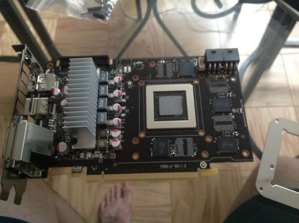

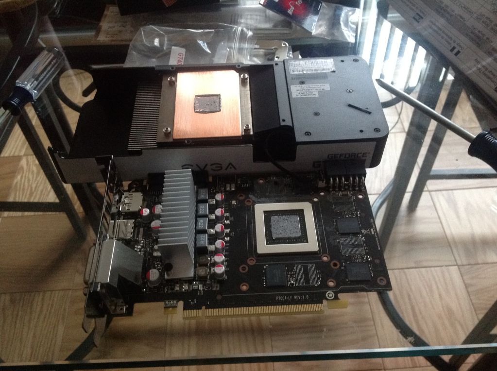

Without the cooler:

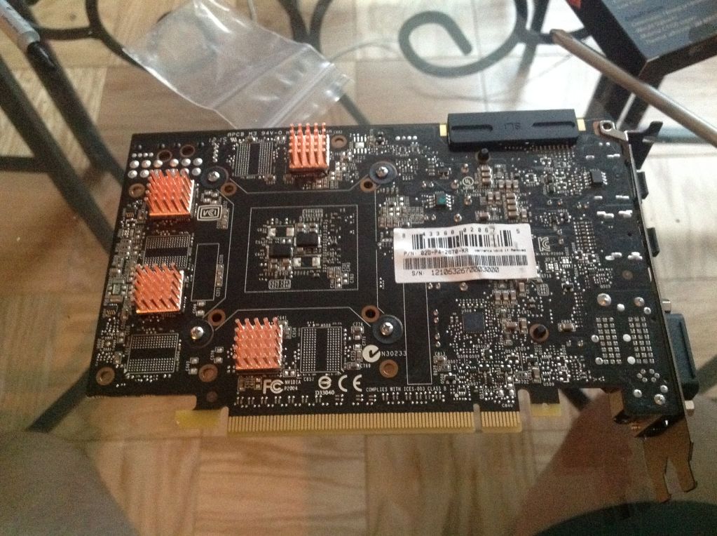

Mounted the Enzotech copper heatsinks from FrozenCPU. Very easy since they use a thermal tape that's already attached. [bRemember, there are 4 VRAM chips on the back[/b]

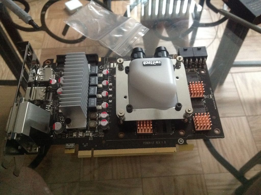

Here's the block attached to the card. If you use the GT400 Rev. 2 bracket, do NOT use the black spacers that come with it. The block will not mount properly.
I need to get more water before I can get temp results, but the card has at least been reinstalled in the system!

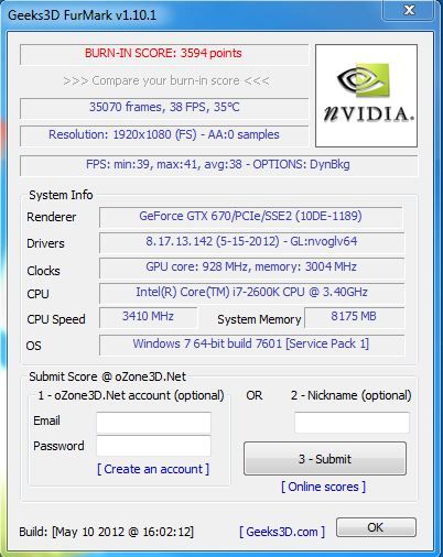

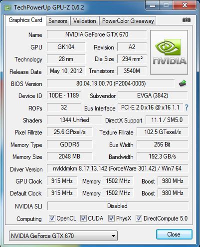

So I finally got the loop refilled this weekend, and everything is running well. Ran the new Furmark 15min Burn-in Benchmark @ 1920x1080, and here are the results.
Idle (room) temp was 24-25C; load was about 31-33C, and max was 35C by the end of the test (PC is under a table). I think I'll see around 32C gaming, which is pretty good for the GPU since the 560Ti ran at about 34C while gaming for long sessions.
