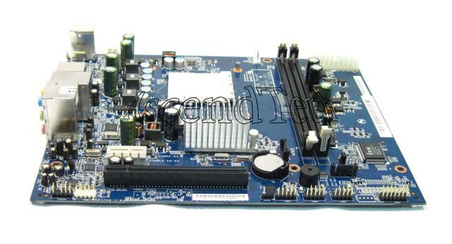

Here's the thing. There is a pinout for an x16 slot on this board. If you then go look at an Acer X1200 or AX1200 you'll see it's the SAME MOTHERBOARD but there is an x16 slot and it has an 8200 graphics on-board instead of 6150SE.

I am adding a reply to show what I'm talking about. On the EL1200 motherboard there is no HDMI port and there is no x16 slot, but the pinout is there. Look next to the x1 slot (white).
And on the Acer AX1200 motherboard it has the extra capacitor back by the HDMI port and it has a black x16 slot next to the white x1 slot. Otherwise these boards are darn near identical and there should be no reason it won't run in my computer.
So basically I just want to know if soldering in an x16 slot would work on the EL1200 board. I bet a soldering iron and a plastic slot costs a lot less than a $55 motherboard.

So, if a company makes two motherboards and they just don't put a bracket over a set of pins on the one board, it can't be done? So we can cut a hole on the x1 slot and use an x16 card at low bandwidth, and we can change out stuff that fits into brackets, but we can't ever change a bracket? It's never been done? No one has ever tried it? I'm feeling like a pioneer then. I'll feel like I did when I took the driver's seat out of an old taxi and found there was a harness for a power seat under there and I was able to put in a power seat, plug and play. Or the time I put a radio in a truck that didnt' have one when new. Gosh, I had to remove this piece of plastic, and find the radio plugs on the wiring harness, and then put it together. Awe-inspiring stuff, that.
Hrmmm...I think what I'll do is buy an AX1200 motherboard and go ahead and run it like that. The 4450B will work fine in there, my RAM will work fine, the 8200 graphics will work in Hybrid SLI with maybe an 8500GT or 8600GS or something, and then I'll have an HDMI port as well. It'll be a good excuse to upgrade to 7 after assembly and testing.
