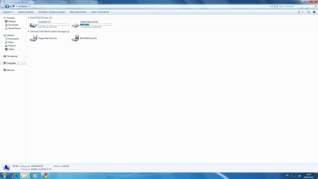

#1: My SSD isn't showing up. It's connected properly though. When I installed win7, it wasn't recognised. Even when the HDD was disconnected. I have AHCI enabled.
Here's a pic.

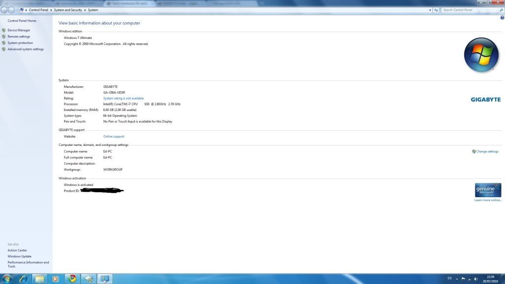

#2: I have 6GB RAM. Windows says 6GB is available, but 2GB is usable. BIOS says the same, but CPU Z says there's 6GB available. Suggestions?

Where is your SSD connected? If it's not on the ICH, get it there! Ideally, with that board, you want your SSD (assuming you intend to boot it) on SATA2_0, your other HD on SATA2_1, your DVD on GSATA2_8, and any front panel eSATA connector on GSATA2_9; run the ICH (the first set of BIOS entries), the rear panel eSATA controller, and the GSATA 8_9 controller all in AHCI (AHCI on the Intel ICH will give you TRIM pass-through for your SSD; on the other two controllers it will give you 'hot-plug' for the eSATAs; disable the Marvell...
The only thing beside hardware I've ever seen (and rarely!) for the 'useable' RAM problem is to open msconfig (just type it into your search bar and hit enter), select the 'Boot' tab, and click on the 'Advanced Options' button; check "Maximum Memory", and scroll up to the amount you should have; apply and reboot - if that doesn't fix it, you have a bent socket pin under your CPU (90%+ likely, unfortunately...) - see i3/i5/i7 'Missing' Memory in the 'sticky'...

I connected my HDD to the blue SATA connectors on my mobo, and the SSD to one of the white connectors (I think GSATA2_7?). Should the SSD be connected to a higher SATA # than the SSD so it boots first?
As well as that, should I install win7 on the HDD and then use the kingston software to move it to the SSD, or try to install it just on the SSD, then connect the HDD?
The lower number connectors come first in the 'native' boot order; you can actually set them any way you want in the BIOS, but I always maintain it's best and easiest to plug 'em in in the order you want 'em to appear... Easy way to do your setup (assuming you're using a tower case, with the board mounted vertically): plug the SSD into either one of the top two blue SATA connectors; plug the hard drive into one of the next ones down (essentially, the middle pair of blue connectors); plug your DVD (and front panel eSATA, if any...) into the bottom pair of white connectors; leave the top pair of white ones empty...
I would plug 'em both in, make sure that, in the win installer, they both actually appear, and appear in the right order (i.e., your SSD should appear as C: or volume 0, and the hard disk D:, or volume 1...) and then do the install directly to the SSD.

When I had my ssd connected, shouldn't it still have been recognised? Even when installing Win 7, it wasn't seen by my computer. :-(
