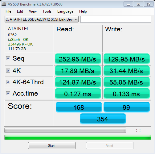

What does AS SSD tell you? HERE and what does it tell you at the top left.
Example:

Lol flat buttons :p
Thanks, but no difference to device manager or HD Tune.
BUT, for some reason, some programs (including some parts of windows) are detecting all the drives as SCSI now :D
But i don't think it's making an iota of a difference since i had about 4% higher numbers when the drive was fresh. T
The RST GUI is reporting stuff running as SATA-I (DVD drive) or SATA-II (SSD and HDD), so i guess its fine.
Anyway, thanks man. You get the best answer after all :p

Negative mate.
you're getting the performance you're supposed to get atleast-
Performance
Sustained Sequential Read
Up to 270 MB/s
Sustained Sequential Write
Up to 130 MB/s
Thanks for the BA BTW. [:russk1]
