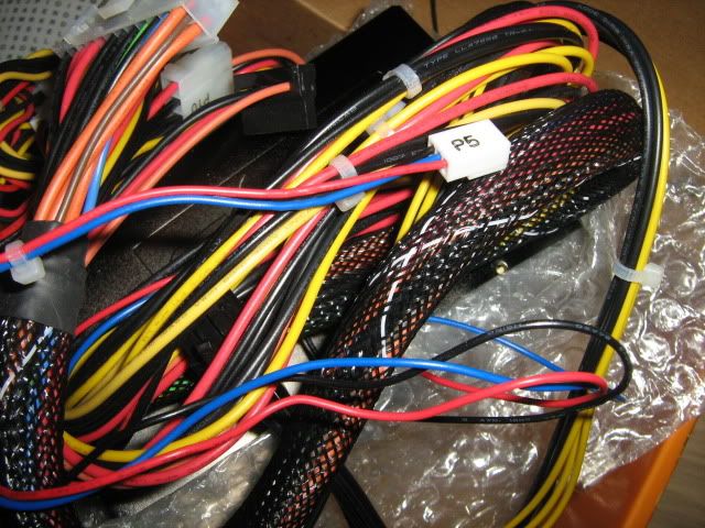

I have just bought an Asus A45-GA 450wt power supply and it came with a 2-pin fan connector lead that was attached internally. I know this is for the internal 12cm fan but upon testing it I found that the fan worked without this lead connected, but when connected the fan gained super sonic speed and the led lights were brighter.
Now without the lead connected the volume of the fan is nice, but with it connected the fan becomes much louder.
Can someone tell me why this 2 pin connector lead is attached, what is the point of it and do I really need to use it ?

Sorry, I meant that the lead was attached internally and came out of the psu with all the other leads. Its like an additional 2 pin fan lead from out of the psu.
But the psu fan still works without using this connector, all the connector does is make the fan much louder (and faster) and makes the led psu lights go twice as bright.
Its the first time ive seen a psu do this and I wanted to know why it did this and if I needed to use it.

So your saying you have a two pin lead coming out of your power supply this is probably the lead that goes to your motherboard so it can monitor your power supplies fan connect to the power header on your motherboard if there is one dont connect to just any fan header it has to be the one for power only if there isnt one on your motherboard just leave it be.
What motherboard do you have?

Darn its a 3-pin connector, not 2-pin. My mistake.
I have an p35c-ds3r from gigabyte.

OK on your motherboard next to the red memory slot there is a header marked pwr fan connect it there. It will allow your motherboard to monitor the power supply fan.

Thanks, it just seemed a little odd.

my seasonic has one too, but its generally rotating too slow for speedfan to detect it. SAAIELLO got it in one.
