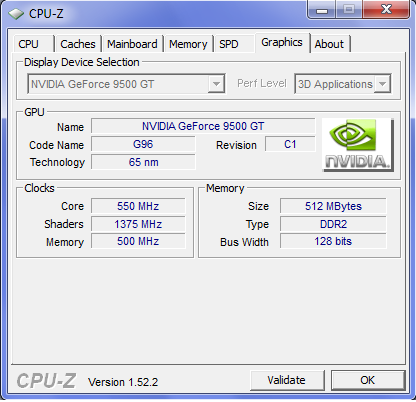

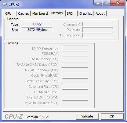

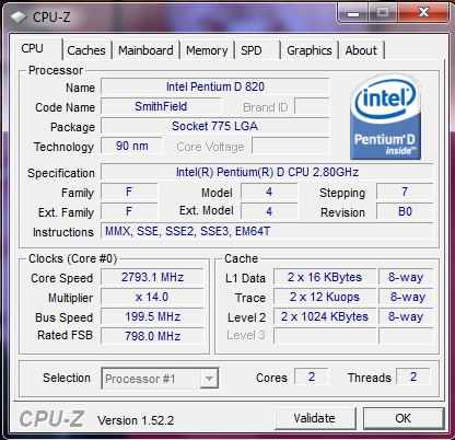

Lets start off with my PC specs........
I've been reading up about updating my computer.... I definitely need a better gpu but thats better then my processor right now.... I'm wondering how good of a rig i could get by upgrading the GPU, CPU and maybe the main board.... after i thought about it im half way to building a new computer then. Are there parts on my computer now i can use if i buy a CPU/Mobo combo? I use the computer for gaming, work, school, and a little editing. One game i play with my younger cousin is silkroad. With just running silkroad it uses usually 70%+ of my cpu when you pull up task manager. I dont have the money to go out and buy a great rig right now... Id like to start with the CPU/mobo combo using parts I already have then upgrading them in the future.
Thanks ahead of time for the advice.

In my opinion go for a quad core, And you should probably upgrade that graphics card too. The socket 775 series have kinda been phased out because of the new i5/i7 so i would probably suggest that you upgrade to a i5 which leaves you for future upgrades open.

I don't think 305w will be enough to power any home built these days unless your using a low profile graphics card etc etc, It may cost more $ but i would suggest going with a 600/700w with Crossfire or SLI certified which leaves you open to another graphics card in the future. And sorry you probably wont be able to use your old DDR2 Ram.
And you need a new Processor because of the slot used in that motherboard for the i5/i7s
since your processor is LGA775 and this motherboard is LGA1156 and of course new DDR3 ram, But don't think that you need heaps of RAM at the moment, Its going to be open to upgrades like i said.
