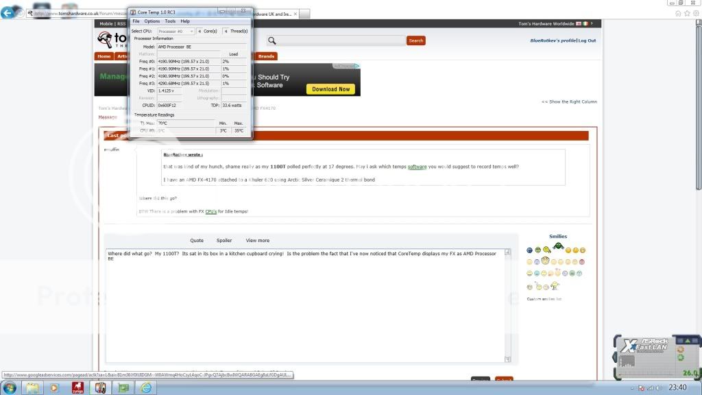

Where did what go? My 1100T? Its sat in its box in a kitchen cupboard all on its lonesome. Is the problem the fact that I've now noticed that CoreTemp displays my FX as AMD Processor BE
http://i326.photobucket.com/albums/k424/BlueRotkeV/Scre...
I so hope this is the case, maybe I should run Prime and see what happens!!??

No, it doesn't, that is a downgrade, the FX series IPC is pretty bad even when compared at overclocked speeds, it isn't really 5.2c idling the software i reporting it wrong.
If you were to go into BIOS and read the temperature there I can assure you it won't read 5.2c. Said from a fellow FX user.
August 11, 2012 8:11:26 PM
It's a shame to hear that as I really rate mine. So you reckon I should go back to my 1100T? Bios is showing 21 degrees CPU and 22 degress mobo temps.
