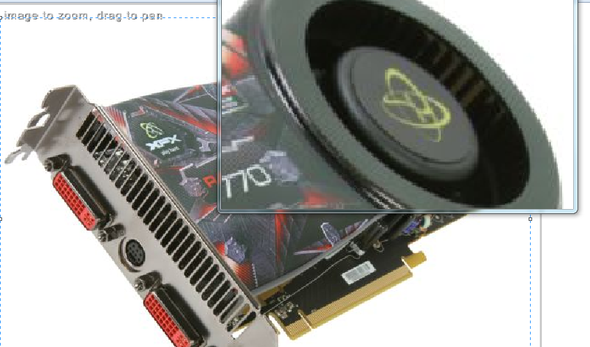

I recieved my XFX 4890 V1.6, it means i have the 4890 with a bigger fan smack in the middle. thinking it would be a great cooler i got excited. Played crysis maybe 20 mins and my computer crashes from what is most likely an overheat. The fan is at 100% (not as loud as you think D:) but when i put my hand near the exhaust at the back, the slightest amount of the hot air comes out. Why is this happening? why is it not cooling properly?

Hey and when its about to crash, the game freezes for like 1 second, then 2, etc until it freezes completely screen turns green or blue and causes me to restart.
but its the fact that NO air is flowing out of the exhaust so its bottled up in the heat pipes and im wonder why no airflow is shooting out like my old 4870 from HIS was .

From that picture that cooler, setup-cover is not meant to exhaust ALL air out the back. It just happens to use the grilled double slot design. The fan is blowing air on to a centered finned heat sink, blowing in and to the left and right.
Other designs use a different style fan , I want to say turbine ? Its similar to what a car uses for its air intake for heat and a/c.
