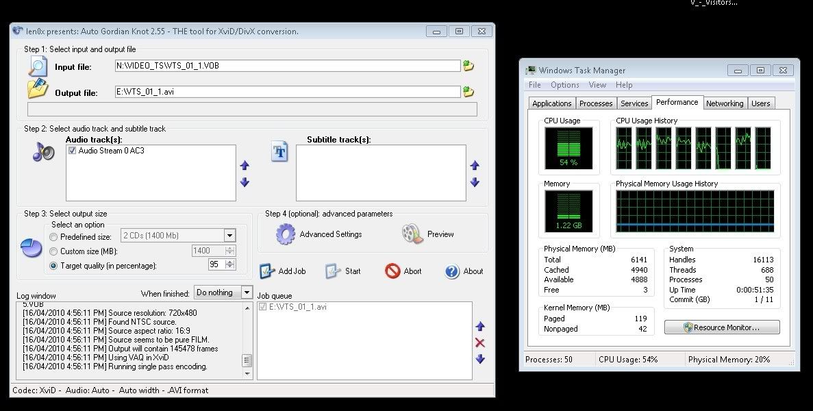

My Results with a Desktop Grade Core i7 920 @ 3.8GHz (One of my Encoding Servers).
Looks like it's an AutoGK issue. It appears to not like HyperThreading. Try Disabling HyperThreading in the BIOS :)
http://img.photobucket.com/albums/v51/ElMoIsEviL/AutoGK_Performance_8Threads.jpg
http://img.photobucket.com/albums/v51/ElMoIsEviL/AutoGK_Performance_8Threads_2.jpg
Message edited by ElMoIsEviL on 04-16-2010 at 11:37:25 PM

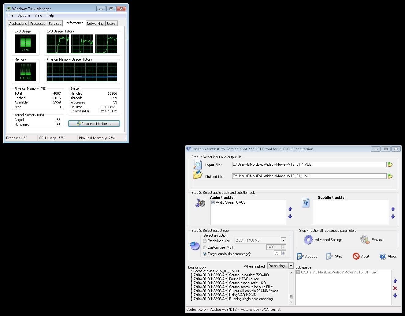

So I went ahead and also tried it on a Phenom II X3 720 and this is what I observed:
http://img.photobucket.com/albums/v51/ElMoIsEviL/AutoGK_Performance_3Threads.jpg
It does appear that AutoGK does not like Hyperthreading.
