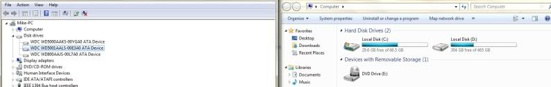

Hey guys, I've got a problem that, from what I've seen, is unique to myself.
I just upgraded my 32 bit Windows 7 to 64 bits. After upgrading, however, one of my hard drives has completely disappeared from My Computer.
Here's an image of my problem.
(Apologies if the image is too small)
The missing hard drive is the one I have selected on the left, but is missing from the right.
Thanks in advance!

  4. The drive in question will be in disk management even though it is not listed in my computer. Right click on computer and select manage then in the window that pops up select disk management , your drive will be listed there as unallocated space. Right click on the drive and set the new partition and then format it and give it a drive letter.

    I installed EASEUS Partiting Master (Free edition), select the unallocated space (missing partition), then resize the drive. After that, giving a letter to the drive (e.g D), then it will be shown in My Computer, and get all my files back without format the drive!
