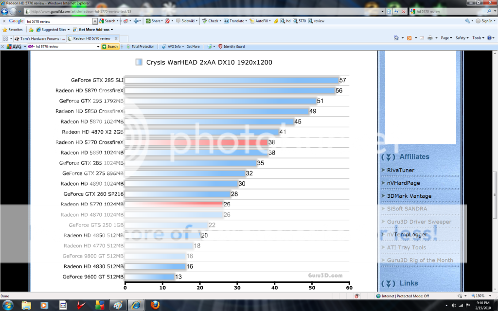

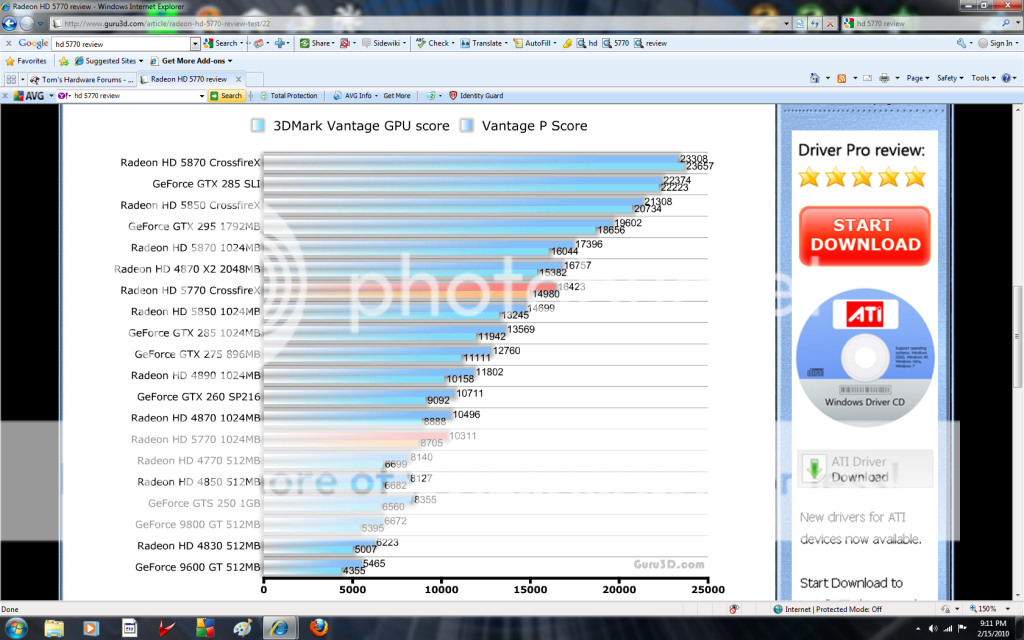

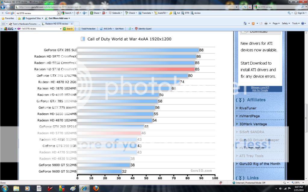

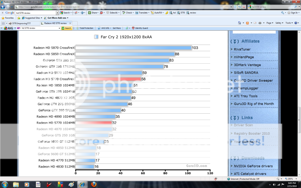

Well it probably will in a few, here it beats the gtx285 in some games, mostly older ones that would benefit more shader power.
There is no 'bottleneck' occuring with this card, it is what it is and at 3 times smaller than a 285gtx it certainly isn't 'huge fail' under any circumstance.
