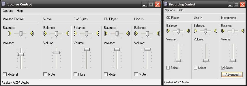

Review the following image, you only want (1) recoding device and cycle through muting some of the devices:
