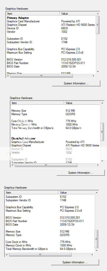

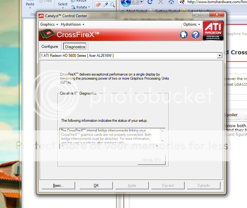

I just built my computer today and I'm still not used to all the new technology. The 5670's say they are crossfire ready and neither of the video cards have bridge. Apparently they do not need them but the catalyst control center wont let me set up crossfire saying the cards are not bridged. What am I doing wrong?

The documentation for the motherboard pretty much said that it depends on the video card. I noticed that catalyst is reading the second vid card but is saying it is disabled

Your right Keropi. This particular model does not need the bridge for the reason you stated. That's why I don't understand why catalyst is saying I need to bridge the cards in order to enable crossfire. I've made sure the drivers are up to date as well as the catalyst software. I'm wondering if it my power supply may be to weak. Here are the specs for this system.

The 5670 doesn't need the bridge, however the mobo must support PCI-E device to PCI-E device communication, I think most LGA1156 mobos made by Gigabyte do however.

Yes. This one does according to the manual. I know both video cards are ok. I have plugged the monitor into both cards and they both work fine as well as swapping them out on the Mobo. I just cant figure it out.
This is also what I'm seeing in the information center which says the second card is disabled.
