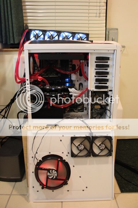

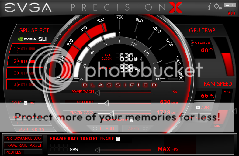

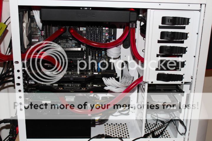

Gonna need some more help here, I've got my new 480 rad, hooked up 4 NZXT FZ-120mm's to it, but my GPU2 temp is STILL climbing up to 60+ C idle-ish. And I mean all I am doing is surfing the web and listening to music and it's climbing up there:
Here is a pic of my set up if it helps:
The other three GPUS hover around 31-33, only GP 2 climbs. I'm starting to think something is up with the thermal paste, but after going through draining this beast, then re-bleeding it again... I don't want that to be true...
BONUS QUESTION: Anyone know what could be causing this? The card works fine, been getting enough power too, but the bottom one looks a little... discolored... :

Do you know what sensor that is thats reporting the 60'c?
I think your memory may be the cause of it as 1728MHz is way high for the idled clockspeed, so thats kicking out some heat right there,
I'd have thought mem speed throttled down with the Gpu myself but I'm no expert on Gpu tweaking :p

@Moto, That's how the card are by default, the "classified" evga cards a pre-over clocked. i tried lowering everything as far as it would let me, but no luck cooling it off.

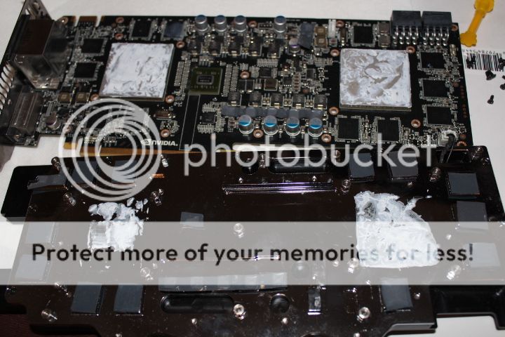

Already drained the loop (pain in the *beep*) and am cleaning the old thermal paste off right now, looks like you all were right, as far as I can see the thermal paste didn't have a good enough connection with the water block... it also looks like the corner of the other GPU isn't connected either, should I be worried about that? I don't have much left over thermal paste, unsure if I can do both of them.

If the paste is new, you can reuse it in a pinch as long as you have good coverage. Can you determine via test-fit where the issue is occurring? It's possible there are minor differences in how the card's components contact the block or that the screws are not creating enough tension.
When attaching and tightening screws, are you doing so in a criss-cross pattern to evenly apply pressure as you tighten?

Preliminary results: It's Fixed! right now my temps are 32 - 29 - 28 -31 and maintaining around there. Haven't done extensive tests yet, will follow up tomorrow after work.

That picture looks like some serious warping of the PCB to give off such a print of TIM that and that the screws aren't applied in a criss cross manner.
But how'd you fix it ? :)

I suspect the block wasn't screwed down tightly enough but the main issue I seee is the use of toothpaste as Tp :p
Grab some decent paste man, you've spent how much on W/c gear and are skimping on the stuff that is a vital link for your heat transference?
C'mon, man up and give your chips some good paste

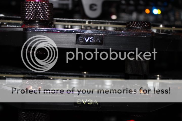

**Edit, whats that wire coming off the fan socket on the card? Is it an LED?
Please tell me you don't have an LED mounted between the card and block?
I'd hope not but have to ask, it would explain the bad seating of the block on that chip
**More editing, is your Ps normally by the radiator that heats the room or was that just for the picture?
you don't want the Pc rads sucking in room radiator heat to try cooling your rig :p

@ Lutfij & rubix not criss-crossing the screws as I tightened it might of been the original cause, in addition to me not applying enough thermal paste. This time I put a *small* bit more than I did the first time, and it looks like the seal is good.
@ moto That TP came with my water blocks when I ordered them, but I wiped off both of em and used some excess XSPC TP I had, which seems to be working well. As for that radiator, no worries it is completely off, I live in dorms and space is limited, so it was the only place I could fit this brick.
Also for that fan socket, can't tell you whats going on with the wires up there, the water blocks are EVGA Hydro Copper. The logo lights up. You can see in one of the above pictures. :p
