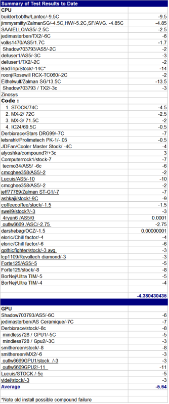

http://i291.photobucket.com/albums/ll300/ICD7/Tomshardwarejuly92010update.png

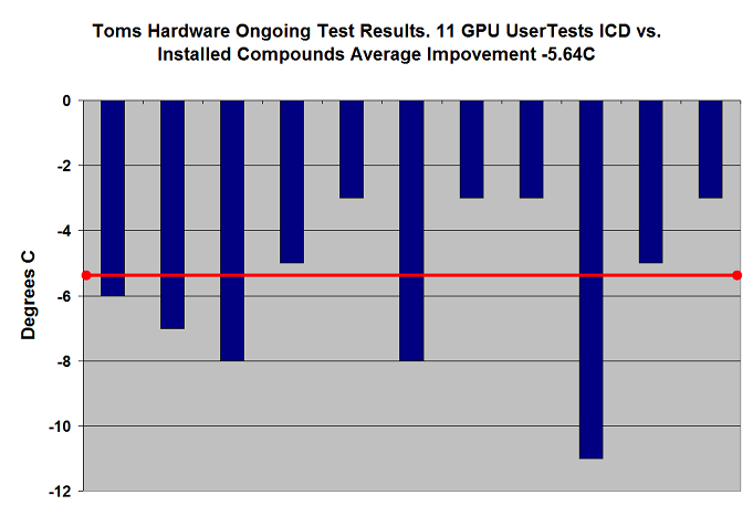

http://i291.photobucket.com/albums/ll300/ICD7/Tomshardwarejuly92010GPUupdate.png
http://i291.photobucket.com/albums/ll300/ICD7/Tomshardwarejuly92010listupdate.png

Results to date - Please Review Any errors or omissions on our part let us know and we will make the correction(s)
[img]http://i291.photobucket.com/albums/ll300/ICD7/May172010TomsHardwareresultsTodate.png[/img]
Reply to IC Diamond

Updated results tally in the first post-any corrections or errors let me know
also added
Added 5/22 - Cure Time- Cure Time averages 2 hours for 1-2 C improvement in most situations for sinks with adequate pressure loading with maybe .5C more overnight.
Lightly pressure loaded sinks may take a day or more depending on the amount of pressure
Reply to IC Diamond
