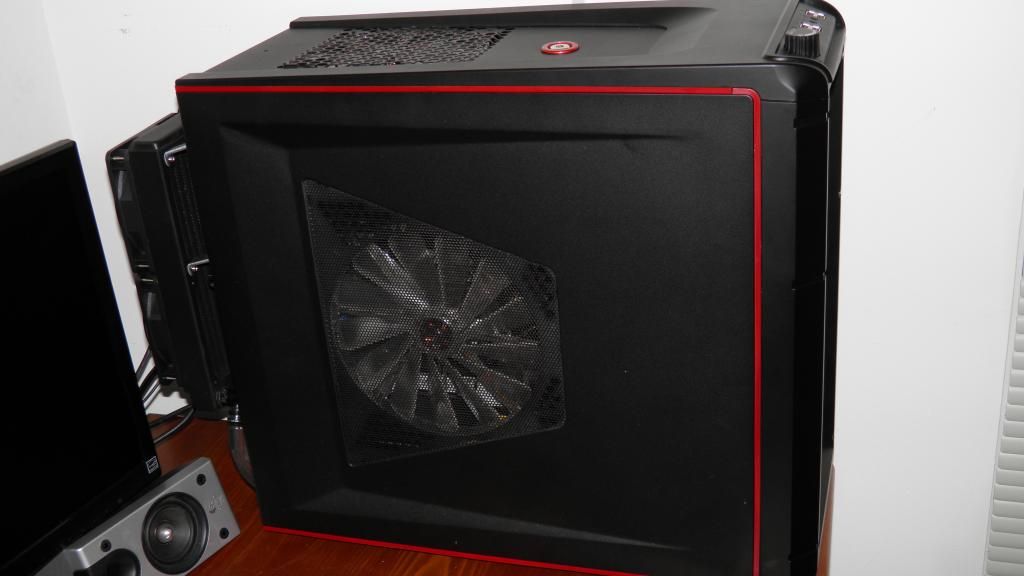

February 1, 2013 3:45:56 PM
skitz9417 said:
hey may i ask hows this setup http://www.pccasegear.com/index.php?main_page=product_i...
I very recently moved from the H60 to the XSPC Raystorm 750 RS240. Comes with everything you'll need. When it comes to performance I haven't seen a big change, mostly the difference is more stable temp wise and the option to add additional devices.
If you have hard bends get 90 degree barbs, they're cheap. The other alternative is to dip the tube in hot water for a minute then bend and hold till it hardens again. Dipping in hot water helps when putting the tube on the barbs as well.

It has aluminium in it so no, google galvanic corrosion for an explanation on that :)
and you could mount the rad on top of your case as mentioned before, the xspc kit comes with some brackets that work really well as radiator mounts, I used them for just that function myself
Mod on man, its half of the W/c game :)
**Edit, ignore the two reservoirs in front of the rad, they're just my touch of class :p

February 1, 2013 4:38:07 PM
Agreed. Looking at the case that you have posted it has the pass-thru for tube. Go with a 240 external rad
EDIT: I don't have any close up of the rad but it uses the same brackets that you can see in Motopsychojdn's post. What you see in my picture is exactly what comes with the XSPC 750 RS240 kit.
Motopsychojdn, love that radiator.

To avoid any serious modding I would mount it as Mop has, hanging off the rear with the tubing fed through the grommets provided
