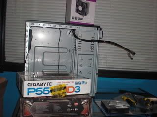

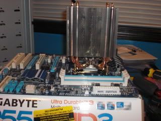

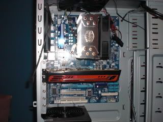

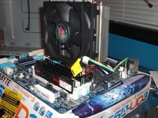

First build finished (woot woot) up and running! Just wanted to say thanks to everyone's input and advice helping me assemble my first build.
Specs
i5 750
G.SKILL 4gb CL7
HD 5770
GA P55a UD3
CM 212+
Antec 300
OCZ 700w
Sony 24X dvd drive
Microsoft 6000 wireless keyboard and mouse
Windows 7 64 Ultimate

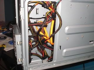

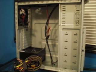

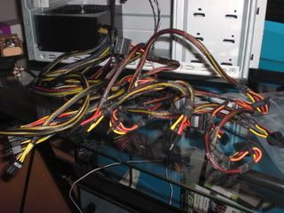

Wiring Nightmare
Finalized
Still looks sloppy but when I get more time I will do some serious cable management! Thanks Again to everyone here at Tom's

March 22, 2010 9:39:34 PM
I say who cares what your wires look like on the backside of the motherboard... Out-of-site, out-of-mind are my thoughts... Looks Good!
m
l
March 22, 2010 10:30:55 PM
I agree, if you cant see them then there is nothing to be worried about.

March 23, 2010 7:00:27 PM
I thought that if the wires are everywhere then it affects airflow? I just built a computer and its a clear sided case but you can't see any of the wires except the main mobo cable. if there arn't many wires everywhere then air flows there the case very well.
m
l
March 23, 2010 8:08:08 PM
Look at the pictures carefully. His wires are beside the drive bays or laying in the bottom of the case (the strength of a bottom CPU case design) and thus not in the airflow paths.
Nice build.

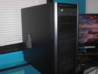

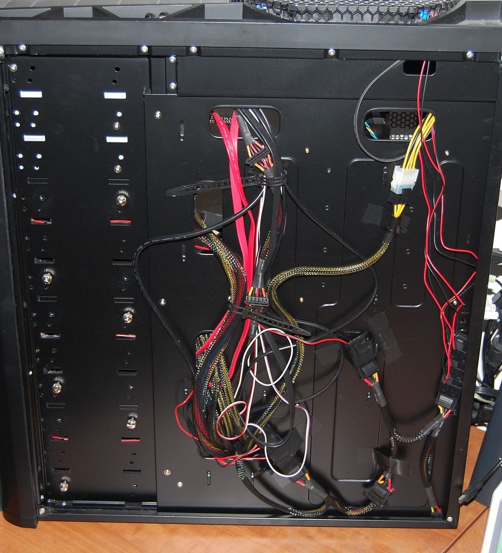

March 23, 2010 8:15:56 PM
Congrats.
With that Antec case you can stuff a lot of wires behind those drive bays and not see them. The only complaint I've had with those cases is that I always add 2 fans in the front and there is no good way to run those wires through the case. IOW the square opening in the case that the fan goes through seems to not have enough room for the wires and body of the fan at the same time. It barely works, otherwise I've thought about notching the cases a bit.
Those fans have a lot of room. I figure with the 2 stock fans pulling air out the top and back, and 2 fans that I add pulling air into the case at the bottom front, there will be plenty of airflow over everything inside.

March 23, 2010 8:44:02 PM
The Antec 300 Illusion model comes with two front dual speed fans already installed (with filters).

March 23, 2010 9:02:32 PM
dndhatcher touched bases on it. The cables are behind the drive bay and don't affect the airflow. Your main concern is getting the cables neat so they are not blocking the airflow and it doesn't matter what they look like behind the drive bays or motherboard tray. Now, many people work to make them neat, as well... I'm just not one of them to a degree.
Back side... Not Important
m
l
March 23, 2010 9:06:33 PM
