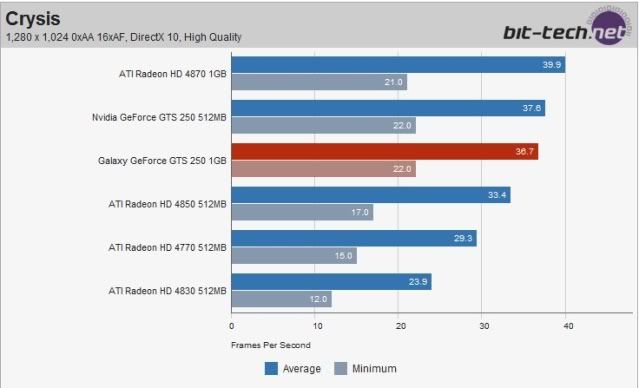

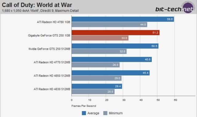

    Please do not recommend a 16x/4x board for CF and do share data/benches on HD 4850 gaming vs GTS 250 in games where it beats the latter

  35. http://www.anandtech.com/show/2756/7
    What's your resolution? At 1400x900 the 4850/gts 250 will play most recent games at high settings. I'm guessing you will want to upgrade in a 1-2 years for just the video card. The other parts will still last a while.
    Jmfranklin what are you looking for in a case? LED's? See through side panel? What do you want us to suggest? there are a bunch of cases that will work just fine.
    *EDIT* Batchuka look at that review, the gts 250 only beats the 4850 at call of duty and only by 3 fps. The 4850 wins on all the other games.
