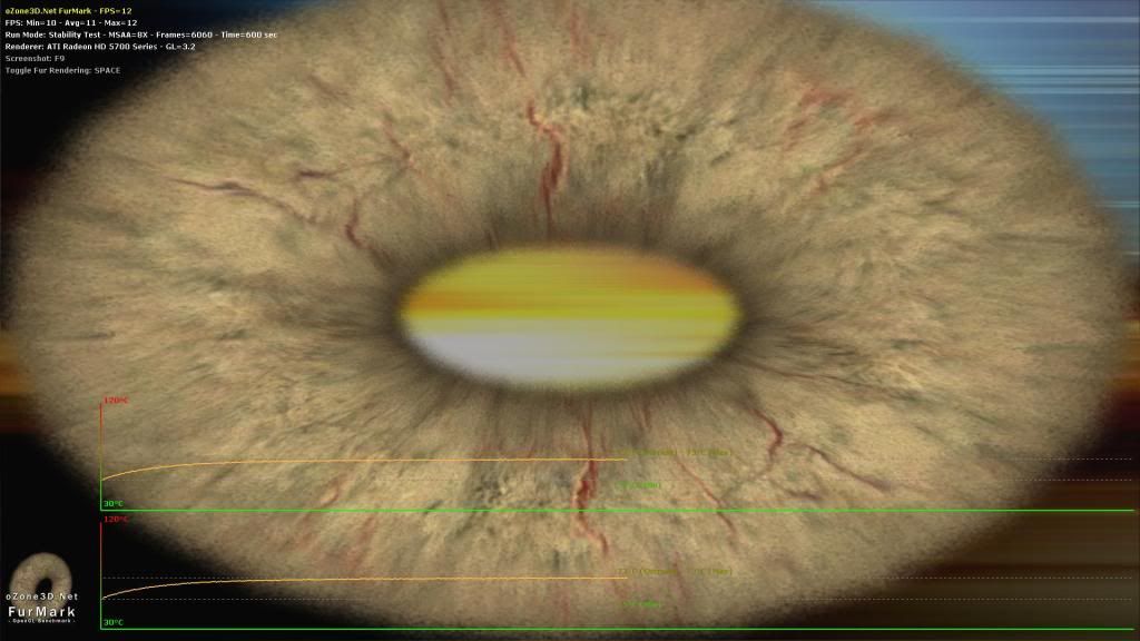

I think I found it. I have version 1.7.0 and ran the stress test with 8x MSAA @ 1920x1080 for 10 minutes (600 secs). My temp topped out at 73c with all fans on auto/low. My min Temp is high because I realized that I wasn't in Crossfire and restarted the test before my temps returned to idle.

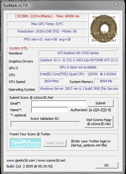

I was bored and ran a benchmark with Furmark, here's a screen shot. I really don't know that much about it. I was in crossfire, but it is reporting 4 GB of RAM and I have 8 GB I swear. I am running windows 7 64 bit home premium.
If you would like, I could run non crossfire.
Let me know.
